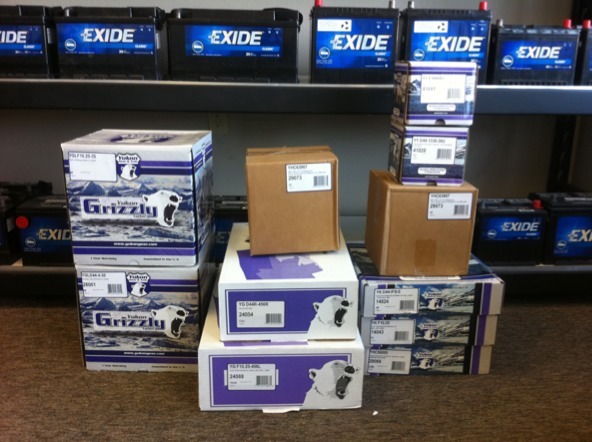

Got some parts in to start the upgrades...

Here are my new rear hubs and 35 spline drive plates, made by Yukon Gear.

Nice! That's a lot of gear. What's the plan?

These are made by Ruff Stuff Specialties and will allow the use of Chevy D60 front spindles and Stage 8 locking nuts. Aluminum hubs would be nicer weight wise but would be more of a hassle prep wise. The goal of this axle is something that I can run for years without anything more than an oil change.

SteveG wrote:Nice! That's a lot of gear. What's the plan?
Sterling center with 10.25 ring gear (Should handle big tires better than the 9"), Also has a factory VSS (less of a pain) with 120 teeth (more accurate on big tires).
Custom hybrid axles (35 spline sterling inner and 35 spline Dana outer)
3-5" wider overall than a stock axle
Baer calipers and rotors (12" rotor most likely)
Parking brake moved to t-case
5/8-18 studs
Flange yoke on drive shaft for quick changes
