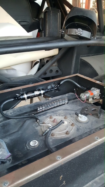

plumbing dual pumps is the plan..
The fuel tank I have has a second fuel line for a generator I will plumb that later...... you can see it in the picture with the cap on it.

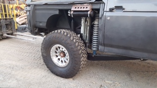

I like how you mounted the rear shock resivors. That looks like it will help keep it cool. It looks out of the way, but is concerns me there is nothing but fiberglass fenders protecting them. They most likily will never be in danger, it's just my luck, I would smack a tree in the pine forest during a Baja race and leak shock fluid everywhere. I want to feed mine outside for better cooling for my 3.0x18 shocks that are into the cab behind the back seat. I have been thinking of linking mine with a cantilever coilover and dampening shock going to the rear. That way I can keep my 3 person MasterCraft Bench seat. Looking good Willie.

I like the idea of more then 3 seats.....

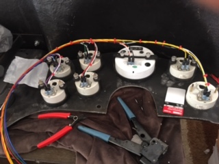

And it has started.....

Come do mine next lol! I've got 2 projects here I've been avoiding wiring the dash, etc. on for a LONG time!
- funinthesun95
- Posts: 1701
Steve it is not fun.... so much is riding on it working correctly
exactly why I have been putting mine off for other things!funinthesun95 wrote:Steve it is not fun.... so much is riding on it working correctly
