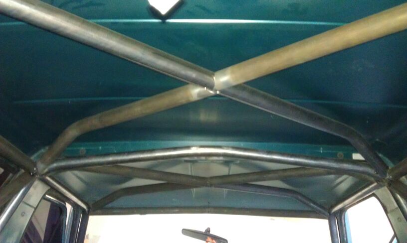

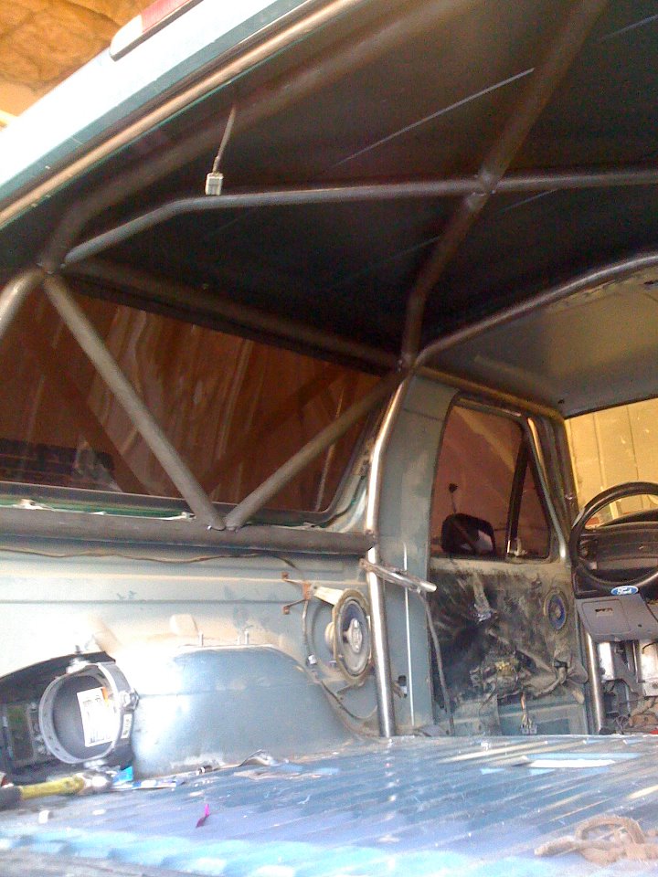

some cage progress. still have a ton more to go.

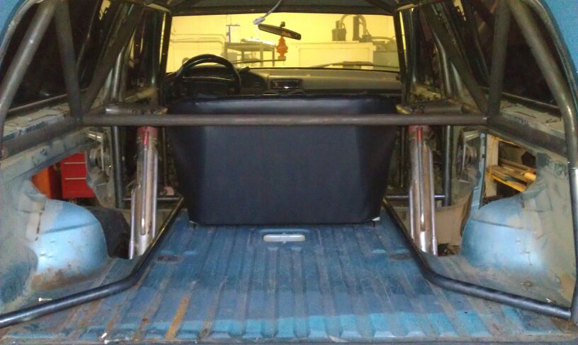

doin the best i can to get this thing finished up but im trying not to half ass it so it is taking forever. not to mention to work on it i have to drive 120 miles each way. here is a couple more pictures. ill update this thread with pictures (camera phone only...sorry) everytime i make some progress. here is what i did on thursday....
-cut out both factory bedsides.
-cut out most of the inner fenders so i can mount 3.0x16 3 tube bypasses
-pulled apart my deaver f53s to bump the suspension
-made the plates for the lower shock mounts
bronco rear suspension bumped and rear fenders cut out. still need to finish the fenders. it was just a quick plasma cut job
inner fender cut out for the shocks.
tube tucked next to the dash

NICE!!!! I'm picking up some of those from the team I pit for. They are last years ProTruck wheels. I have heard they have odd offset...have you test fit them?

the rims seem to fit pretty good in the rear. i dont have 5/8 studs yet so i can bolt them up. more pictures from this weekend
Re: 96 chase bronco
I really like the rear seat.. Who makes It..

Cage is looking good!
