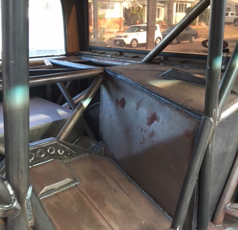

safety cage..... and rear shock mounts ....fuel tank can
