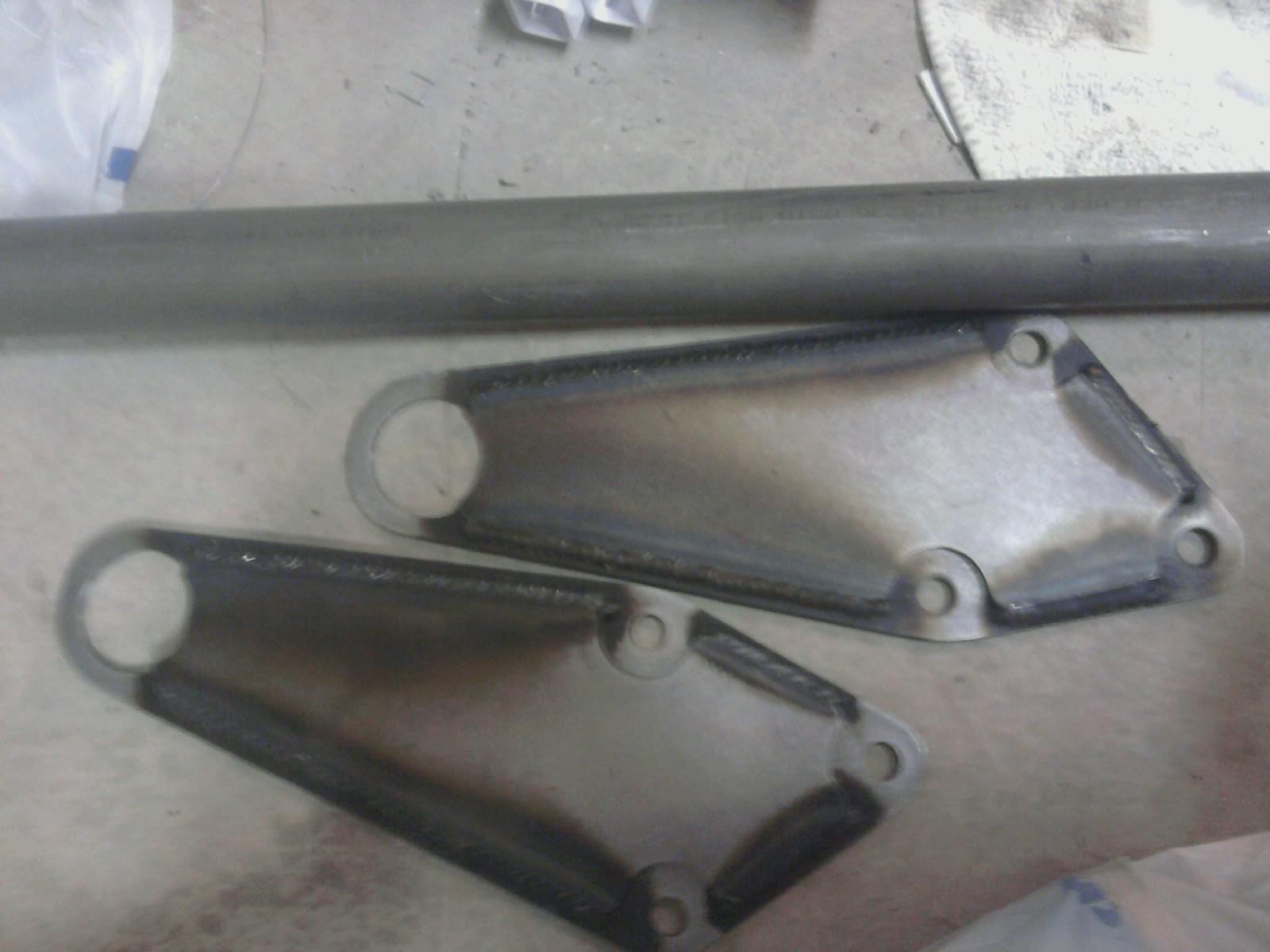

What does the rear mount look like?

I dont have a pic but I'll get one for you tonight. Pretty simple, has two plates welded together on either side with the mounting holes for the original shock mounts. You have to drill the holes to 1/2". The tube slips in and you weld the tube to the plates.

^^ lets see it!

By popular demand, the shock tower. (Some assembly req'd)

Thank you all for the input. Theyre not shimmed or aligned quite yet but its a start!
