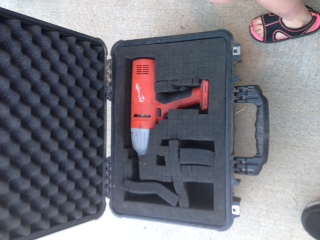

New set up for Bronco road trips.....
- impact bronco2.JPG (38.27 KiB) Viewed 1064 times
- impact bronco.JPG (32.18 KiB) Viewed 1064 times

Red toenails Willie.......ummmmm, wth??
Re: Willie's.....1992
someone was helping daddy take pictures...
And nice!
And nice!

Ya Zoey has to be in every Pic I take......lol
She 2 years old come Aug
Crazy ....it been fun and She is getting strong for road trips with Dad and his Bronco
