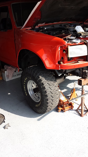

Looking awesome man! I love the look of those raw beams, but do yourself a favor and get them painted or powder coated before you bolt everything on. If you don't, let me know, because I am going to buy WD40 3M stock :lol:
fomoco51
Posts: 300
Location: central California
Re: "project orange juice"
Post by fomoco51 »
Yea they look good but im not about to crawl under there all the time to scotch brite and wd them. They're mounted now for mock up, then gonna pull em and paint them.
I have the same (more or less) beams and radius arms. I left mine raw. I scotch bright & wd40 them about once every 2 months. It takes a whopping 15 minutes. My truck is a princess though.

I would paint or powder if you live near the ocean.
fomoco51
Posts: 300
Post by fomoco51 »
Well its gonna see a lot of pismo sand since its close so yea its gonna get paint. Was thinking a dark silver hammer tone then tie in the bumpers with the same color.

Does anyone know the stock wheel base length from center of rear axle to center of front hub? Wasn't thinking when I tore her apart to mark my center point of the front end. Gonna push the beams forward a 1" but need a starting point.
otter
Posts: 534
Location: Hawaii
Post by otter »
105"
fomoco51
Posts: 300
Post by fomoco51 »
Cool thanks otter

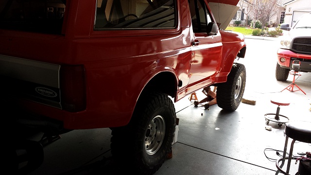

so traded my 15x10 AR baja wheels to my buddy a few weeks ago for some nice stockers. looks way better in my opinion
