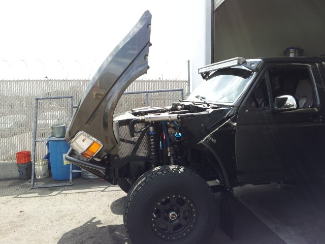

Wow! Your bronco is down right beautiful!. What are the travel numbers front and rear? And what stroke are the shocks front and rear? I'm throwing around the idea of 4 linking mine.

Andy Jones wrote:Wow! Your bronco is down right beautiful!. What are the travel numbers front and rear? And what stroke are the shocks front and rear? I'm throwing around the idea of 4 linking mine.
Thanks, it's at a full useable 18" wheel travel front and rear. It has 2 14" stroke shocks in front and a 14" coil over and 16" stroke bypass in the rear.

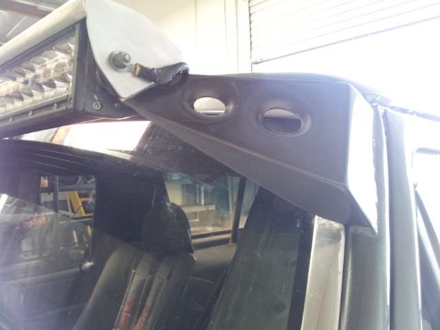

Someone asked for pics of light brackets.

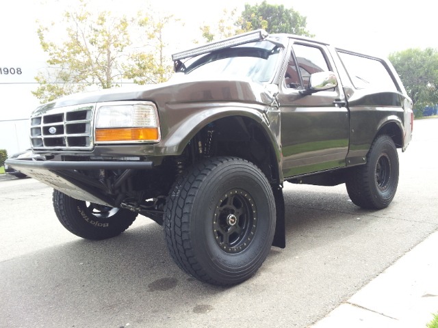

how am I just now noticing the rear bumper? I dig it! Dig the entire truck of course, so maybe I was looking at everything else before & never noticed the bumper.
Re: Jacob 93 Prerunner
Damn this looks great, I am a HUGE fan of the mud flaps!
Damn, total 180, (or maybe 360?) I loved it Orange, didn't like it white with stripes, now I'm back to loving it! Great work and an awesome turn out.

Jacob 93 Prerunner
Post by greaslife »
Going too steel the flap idea. what about in front of the rear shocks? And thanks for the photos of the light brackets appreciate it.
Post by Jacob7672 »
greaslife wrote:Going too steel the flap idea. what about in front of the rear shocks? And thanks for the photos of the light brackets appreciate it.
Do you mean doing the flaps just in front of the rear shocks? Some people do a wide one (as wide as the truck) rite in the center or infrtont of the driveshaft all the way across the truck. But I wouldn't do them that far back. I'm not worried about rocks hitting the shocks really. I put them ther to deflect rocks from the lower links, drive shaft, and rear end. Those are the parts that really get sand blasted.
Post by Jacob7672 »
ESHALLBETTER wrote:Damn, total 180, (or maybe 360?) I loved it Orange, didn't like it white with stripes, now I'm back to loving it! Great work and an awesome turn out.
Thanks, I totally agree with you, I was afraid I would never like this fiberglass but I saw it on some dark colored trucks and it didn't bother me and now I like it on my truck.
Now the only thing that bugs me is how far the bumper is from the body. I already know how I'm going to change it but it's not very simple with were my trans coolers are and how the hood opens. So another day!
