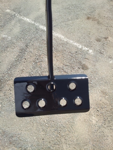

I did take a pic of my new Brake pedal though. Also have a matching gas pedal!
- ImageUploadedByTapatalk1343948793.913662.jpg (137.8 KiB) Viewed 1802 times

You should, really easy. I used the stock hanger and cut off the stock pedal and bent it straight so it moved the pedal about 3" to the left which is perfect if you want to turn it into a 2 foot drive pedal setup. Than you just have to make the pedal and weld it to the hanger. I have also seen some I like that dont even have the dimples and have grip tape.ChaseTruck754 wrote:Looking good! I've been tempted many times to build one of those but have always been too lazy to actually do it. Love the looks of them.

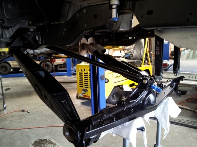

Powder coat is back! Time to assemble and paint.
- ImageUploadedByTapatalk1344385800.142888.jpg (188.23 KiB) Viewed 1762 times

That beam looks bitchen!

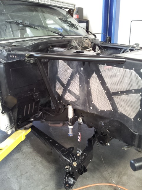

Coming together nicely! Here is today's progress. It's starting to look like a truck again. Might drive it down to paint tomorrow!

- Posts: 4619
Re: Jacob 93 Prerunner
Wow.... thats amazing work...
