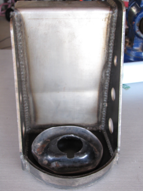

You had asked about the modification I made to my coil-buckets to center and retain the upper end of the coil. That's all it did. There was no adjustment. I can add washers at the bottom of the coil to adjust ride-height if needed. It's not as convenient as the adjusters, but I rarely have a need for them.
What I did was cut the top out of the coil-bucket and welded it into the top of the fabricated bucket. Then I used an Autofab upper retainer to sandwich the top round of the coil and keep it from coming out.
