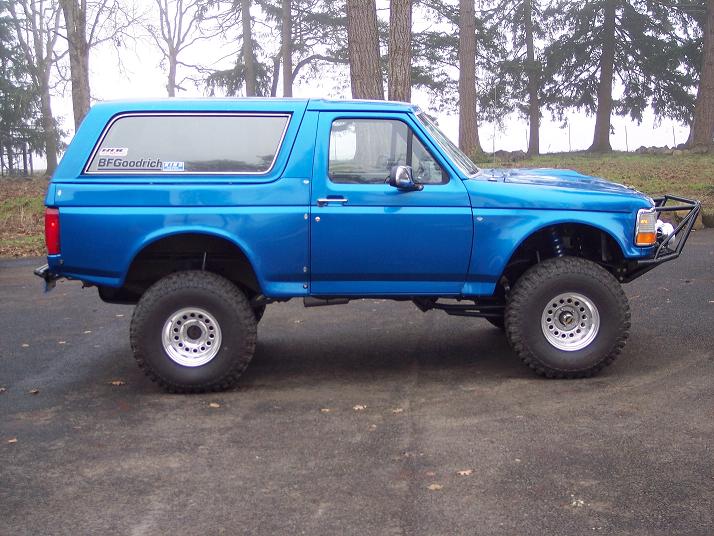

Here,s my 84 converted to newer style glass.Full cage,prp seats,94 351w,C-6,trussed 9-inch,full array Autometers,etc..
robs bronco 008.jpg (92.07 KiB) Viewed 2628 times
robs bronco 006.jpg (94.45 KiB) Viewed 2628 times
robs bronco 004.jpg (90.34 KiB) Viewed 2628 times

Ya I need some newer photos.These are right after assembly from paint shop.Still needed alignment done.Had the stink bug stance.Have fixxed that since this photo.I have,nt even been Off-road with it yet.Need them Deavers and my front bumps still.If the Oregon race in Paisely happens it will for sure be there to Pre-run if there is one.

Looks great! Any pics of the rear bumper that arent in profile view? And what R.A.'s are you runnin?

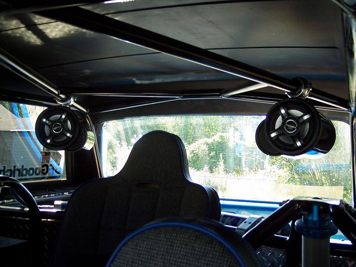

Rear bumper and interior shot.
robs bronco 009.jpg (72 KiB) Viewed 2494 times
robs bronco 008.jpg (92.07 KiB) Viewed 2494 times
yogib
Posts: 170
Re: my 1984 FSB
Post by yogib »
Radius arms are built by a friend of mine.Kevin who built the two badass broncos that i posted pics of.They are setup with threaded ends for future heims.And have a .180 wall main tubes with .120 wall upper tubes (dom).The bumper has welded on tabs for backup lights.And a receiver tube.Kevin built the bumpers as well with my help.I was shop Bit#$ grind,fit,cut.
