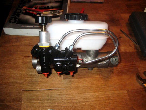

Thanks for the good words Tom. I was just checking out your thread and noticed the 2lb valves. How is that working out? Do you like it? Here's my set-up in progress. Still have to make a mounting plate for the prop valve.BajaF250 wrote:I can't wait to see this truck, you have done a lot of very nice work on it!

Hey Brian,
That is just a very nice setup, period. I think you'll like the proportioning valve... it sure adds a nice abilty to adjust, especially in the dirt. My rear end used to slide around on me and I've taken care of that with the adjustablility.
I put the 2lb valves in to keep the pedal up and they work great, I'd absolutely do it again.

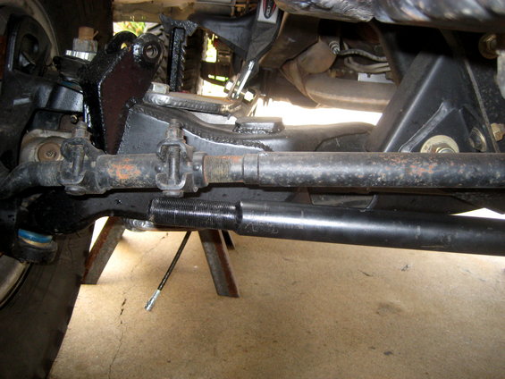

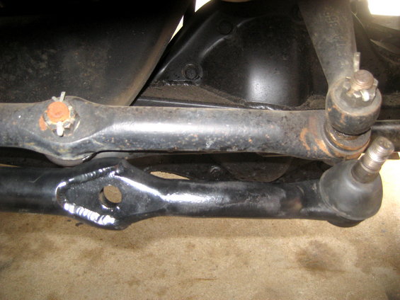

I was at a local wrecking yard looking for a new pitman arm, and pulled one off an early 90's bronco, and next to it there was a realy 90's maybe late 80's f250. the f250 pitman arm just a bit longer like you want, and way more materal. So i pulled both of them, and they were interchangable.
- HPIM1467.jpg (69.14 KiB) Viewed 2008 times
Re: Brian's '96
Thanks for the info Ryan. That looks like a good way to go.
Here's a couple shots of the ambulance drag link vs the '97 F250 that I've been running for a couple of years now. Notice how the eye is positioned different on the two of them. Also notice I lengthened the driver's side to compensate and honestly can't say I've noticed any adverse affects from the different position. The F250 is also a larger diameter all the way through. Both of them have a bend inboard of the eye, which makes that the weakest point. Mine is bent from a couple of hard it's. I think it will get replaced with another F250 link and I'll beef it up around the bend.

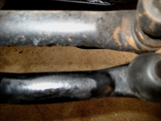

This one represents the difference in girth a bit better. Sorry for the blurry picture.
