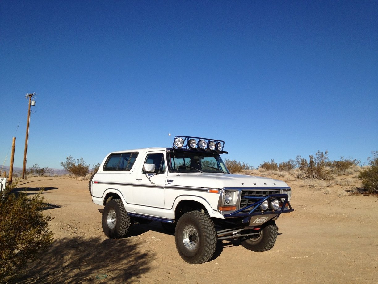

Brought my Bronco out of the garage this past weekend after a couple of years of hibernation. Its a 78 straight axle with a fabricated 9" housing straped at 12" sway away 2.5 on all corners, heimed steering and full cage front to back.

AWESOME bronco! More pics & info on it please.
Oh and welcome!
Re: BACK IN THE DIRT
Thats awesome!!!
I love that body style. Welcome!
Sweet! Welcome to the club!

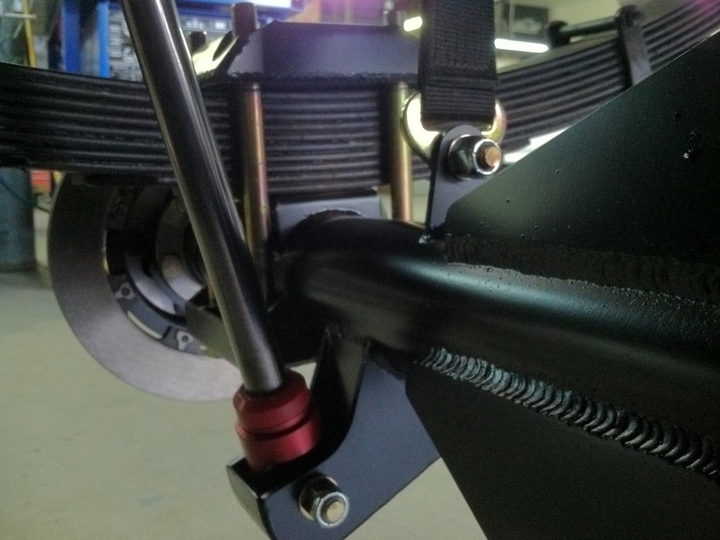

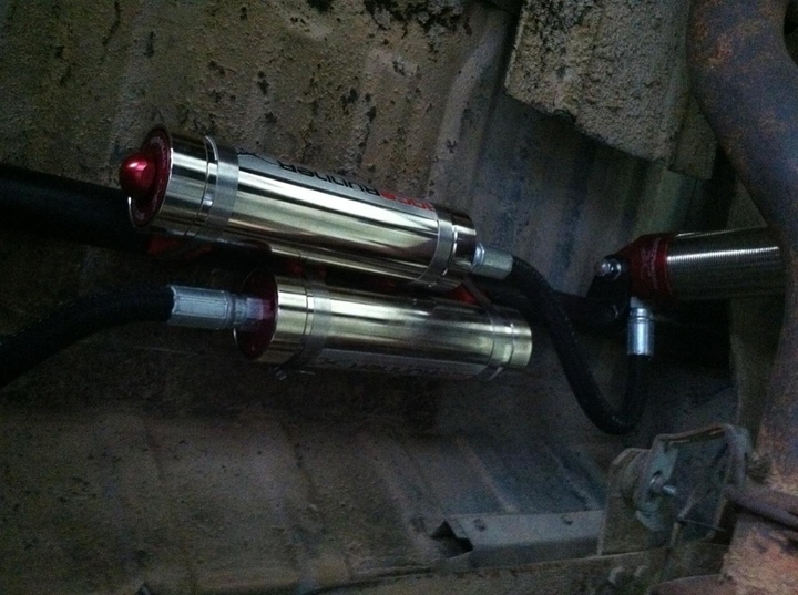

The rear end is 1.5" wider than stock has a detroit locker and Dutchman axles. Deaver spring pack 3" wide, Wilwood brakes. Motor, trans, and transfer case all stock. Front end stock but with heim steering and swayaway shocks. Replaced front lock out hubs with drive flanges after breaking a hub once down in Mexico. Front brakes stock, Deaver coil springs in front. 4.56 gearing front and rear.
