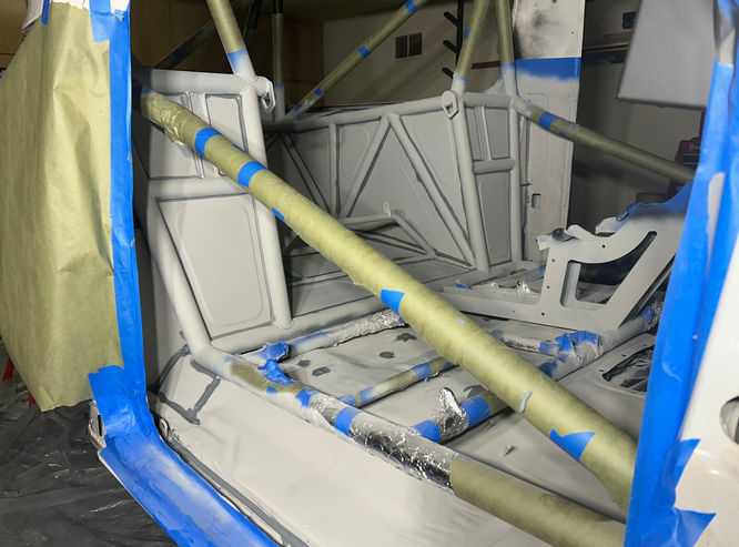

primed and seam sealed
primed and sealed.png (561.5 KiB) Viewed 27552 times
