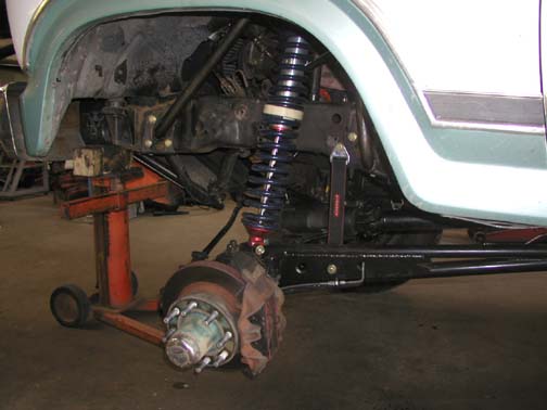

'82 F250, D44HD front, D70 rear, roller EFI Lightning 351 transplant, coilover front, nationals rear, caged... 18" front and rear, sway-a-way all the way around.

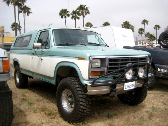

Re: BajaF250
That is a bad ass looking rig! I like it. I spy with my eye Autofab drop down hood and stock width front glass as well! Very nicely done.

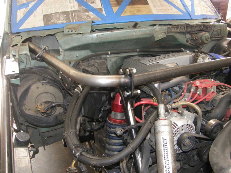

Can we get some more pics.... interior cage pics, etc
Re: BajaF250
Very nice!
Re: BajaF250
Great eye! Autofab drop down hood, glass stock width fenders with 3" higher wheel arches to fit the 35" and uptravel. Alum panel fender wells to keep the stuff out of the engine.

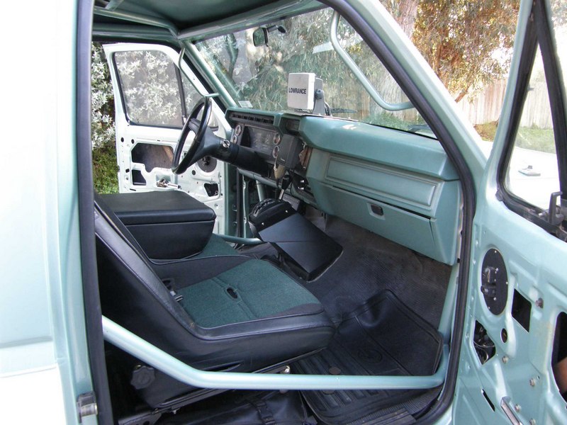

Some more pics of the cab... cab out of paint and then put back together.

Have you ever had problems with any of the D44HD knuckles, bearings, or spindles?

Never had any problems with the knuckles or axles. I busted a u-joint on the passenger side of the D44HD once, but that was directly due to the fact that the mech that I let work on the front end forgot to put the inner race on the right side output differential axle bearing. (I don't let folks work on my stuff anymore!)
Re: BajaF250
BajaF250 wrote:Never had any problems with the knuckles or axles. I busted a u-joint on the passenger side of the D44HD once, but that was directly due to the fact that the mech that I let work on the front end forgot to put the inner race on the right side output differential axle bearing. (I don't let folks work on my stuff anymore!)
That's nice to know. I'm using the same stuff for my Crew Cab but for a 2wd setup. I was originally looking for a D50 setup but the beams I found to cut up ended being D44HD.

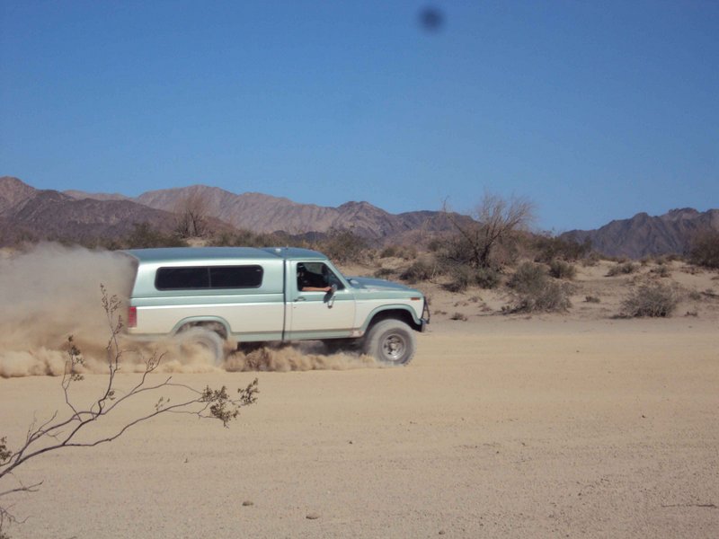

Rumor also has it your on the new BFG KM2s now as well as a shell..... so how about more pics!
Re: BajaF250
The only pic I have with the new KM2s is the pic Yikes posted. I'd put the new tires on and then had the front end painted just before this years 500, I literally picked the truck up from the painters the day before Tech and Contingency.

Re: BajaF250
Now that's an awesome shot!
Re: BajaF250
Thanks Brian, couldn't have done it without you! :D

BajaF250 wrote:Thanks Brian, couldn't have done it without you! :D
Haha! Actually I was talking about the shot above it....100mph in the silt. Woohooo!
