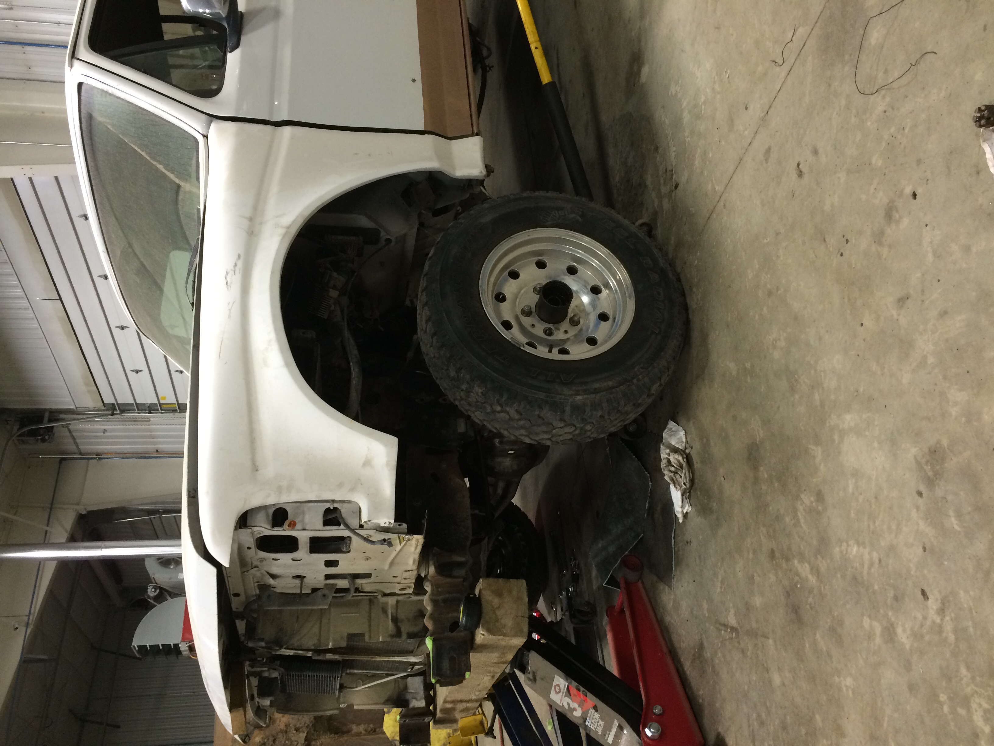

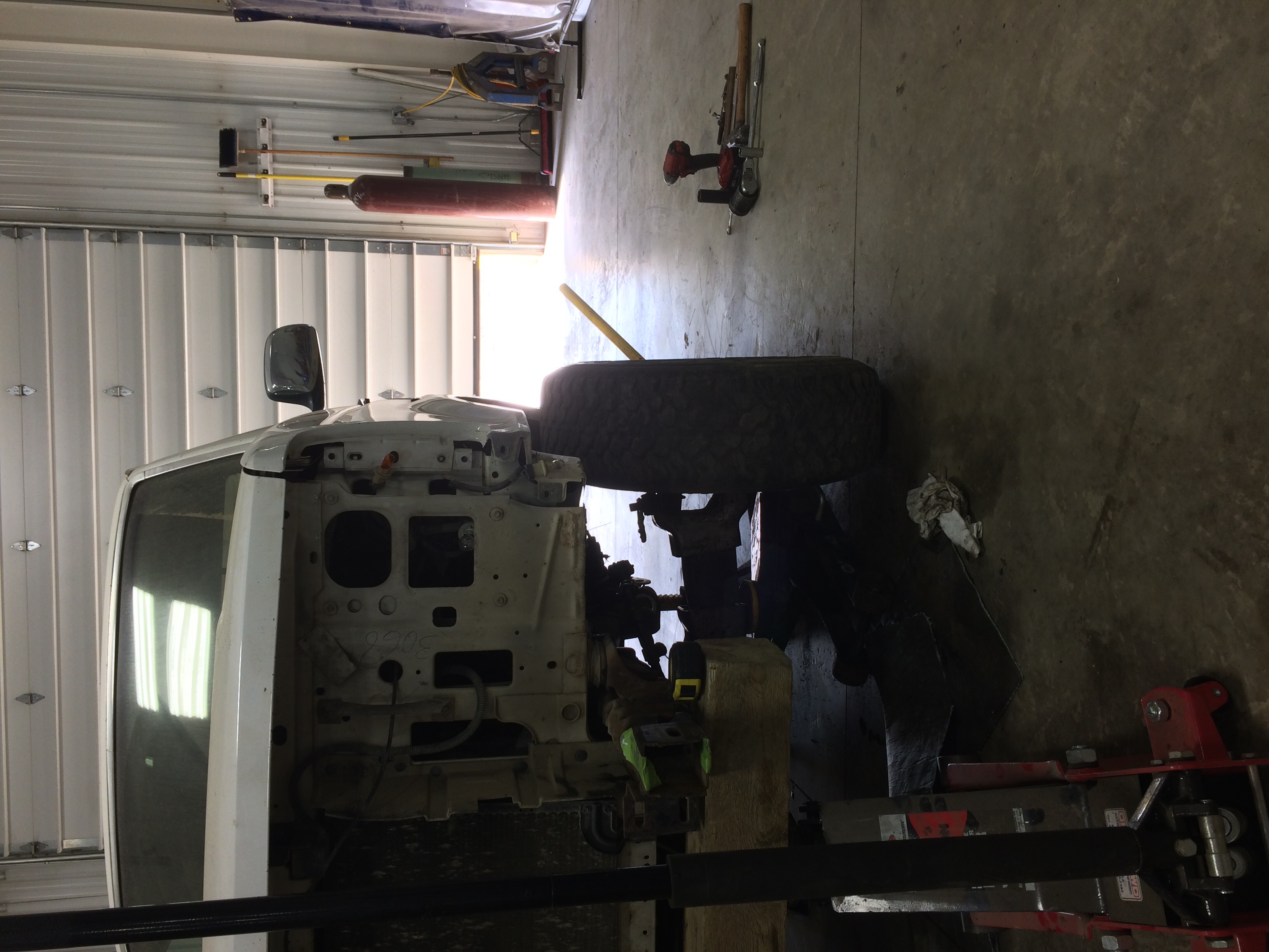

Once I got this beauty back to the shop I had to ditch the bumper and got right to work removing lots of little things, stock suspension parts, side steps, and the stripes ...

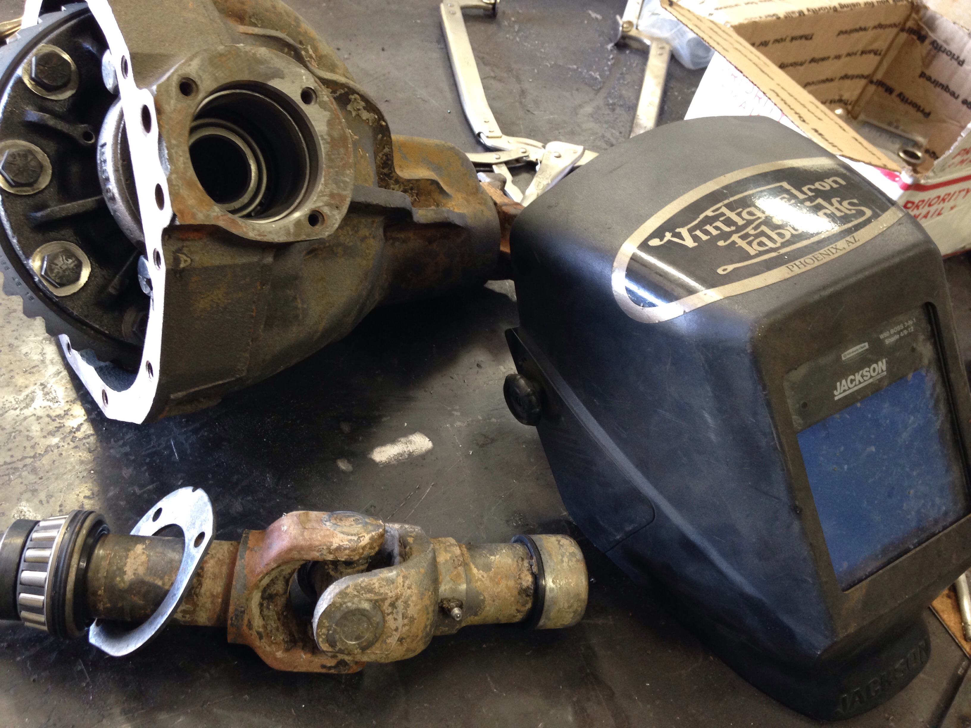

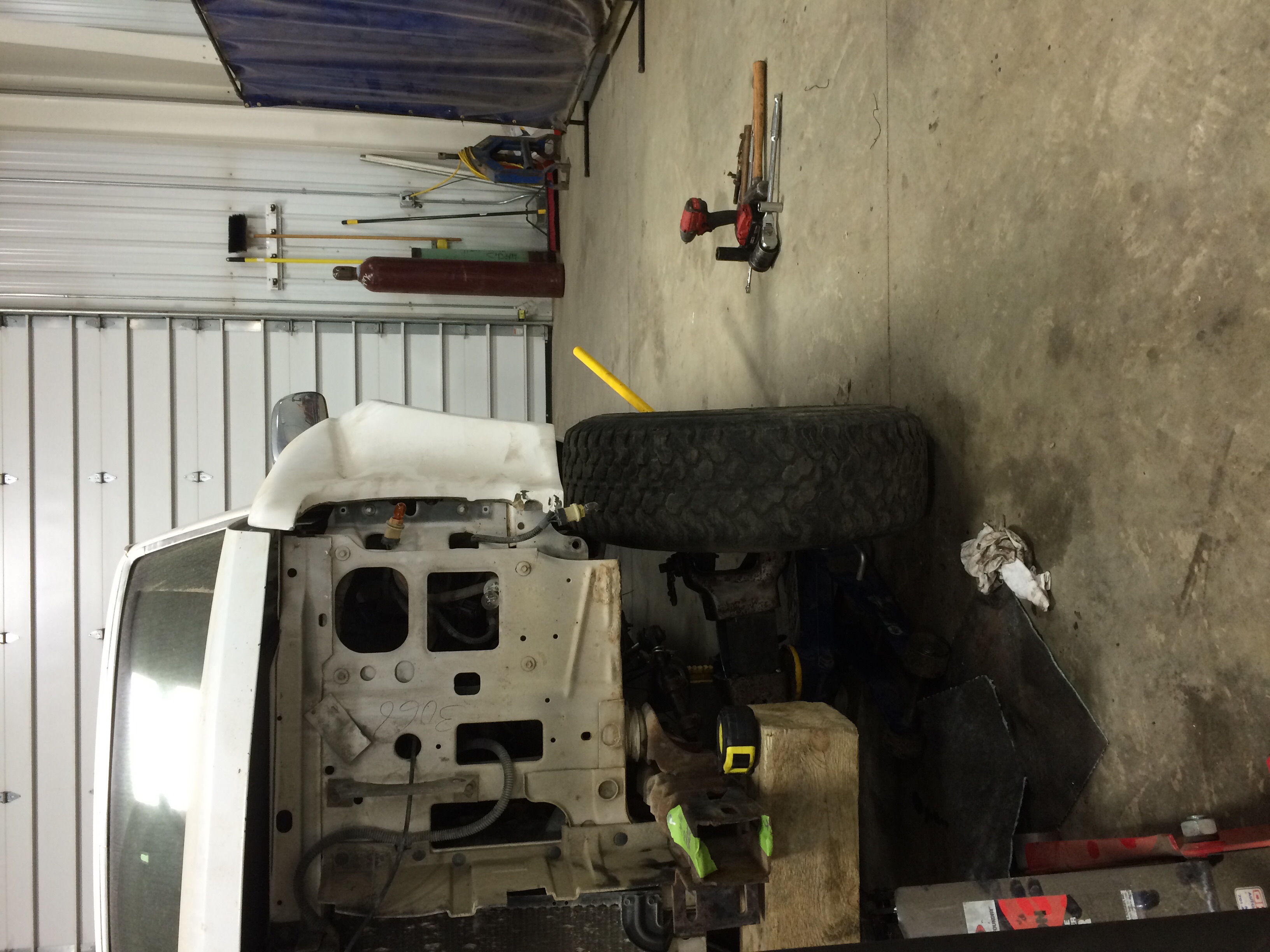

Got the bed pulled off to get started cleaning the chassis, wire wheeling the rails, grinding off rivets, pulling everything off the frame to clean and prep...
BTW-- I must have not taken before pics of the engine and all the drivetrain but it was a HUGE mess of oilcake....

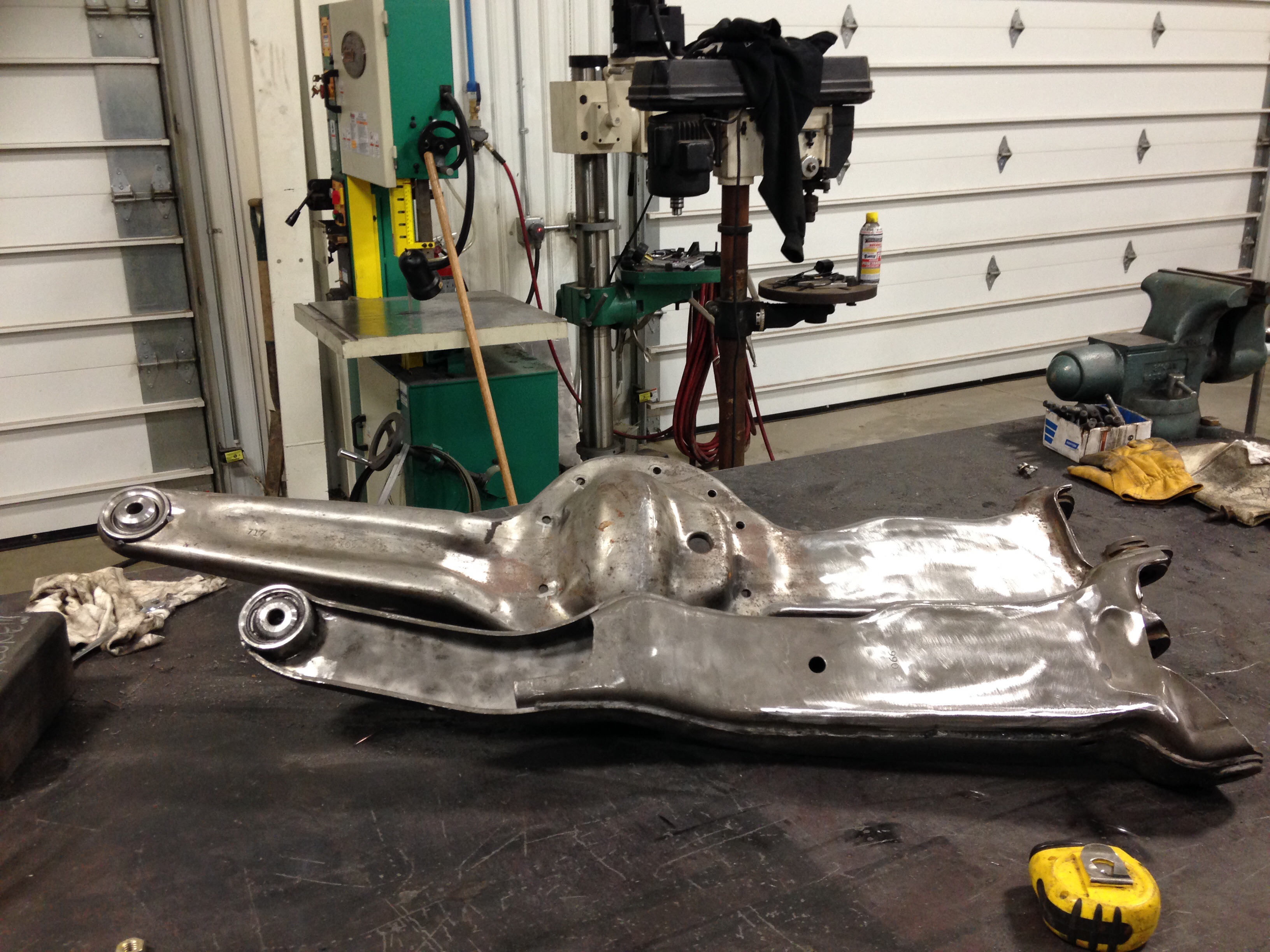

So this is me using this as a sounding board-- I set right height by pulling in slowly and stopping slowly; Measured from the bottom of the frame to the floor; measured the vertical face of hub at static stock height with the wheel on; raised the frame 3"; unbolted the stock beams; bolted on 4.5" beam with a guesstimate; put the knuckle/spindle/hub/tire on.
I'm off about 3/16" with too negative caster with 0* eccentrics. By all accords I think it's almost right on the money. Thoughts on that ride height set up method...
FYI-- the goal is to not mess with the BJ area.

That method should be fine.. Just make sure you check for axle shaft clearance. Before finishing the beams.

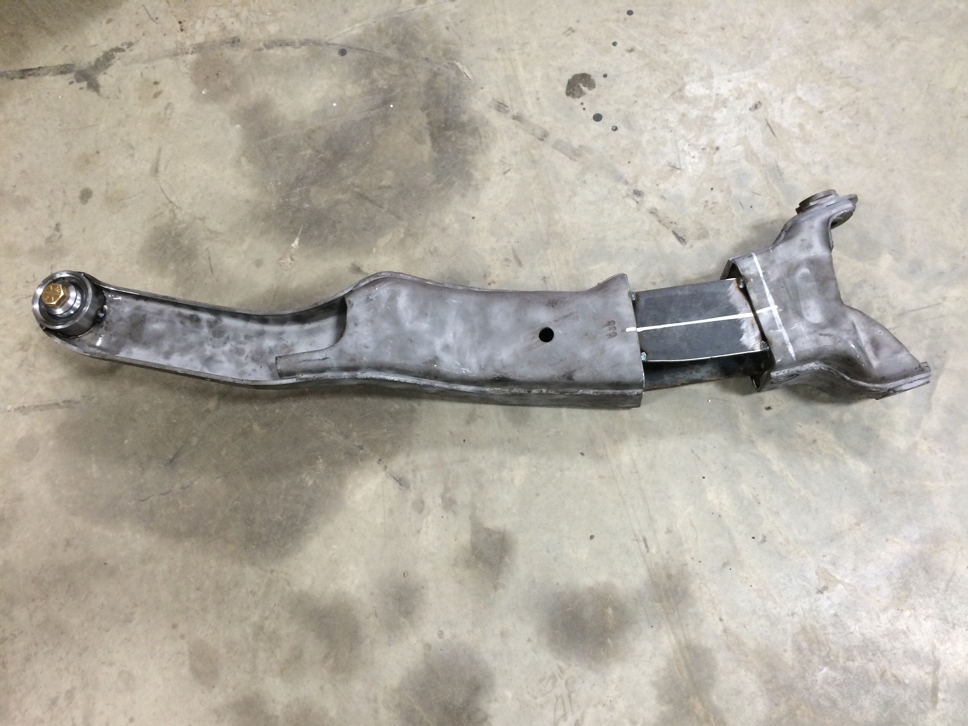

Got my beams done today --almost
Still have to plate and brace them all up. 3" over stock height, 4.5" over width and done with molesting the BJ area. Pretty stoked with the outcome!!

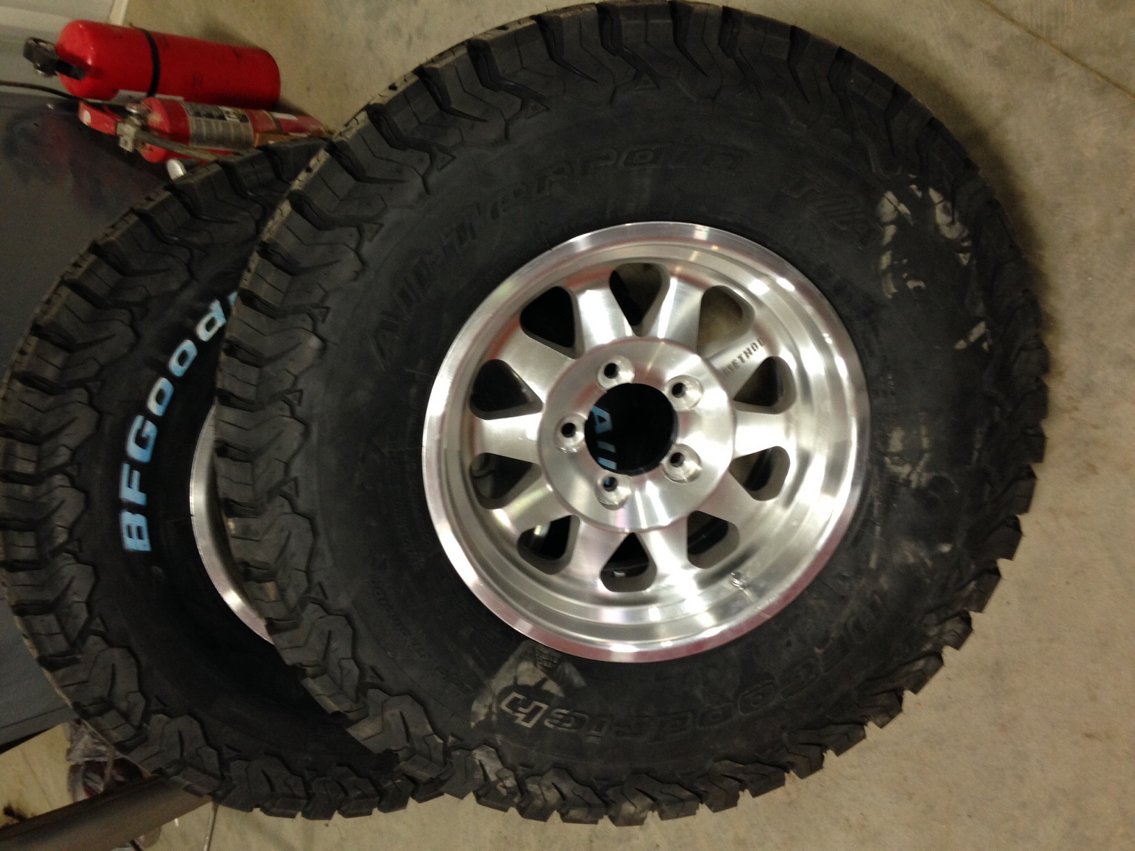

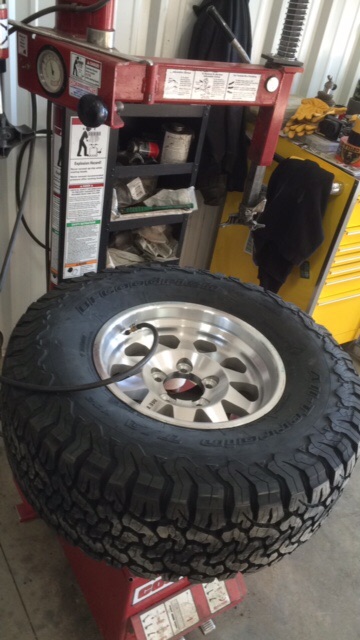

Some bling! The race non- bead locks are so hefty and you don't have to do any machining if you wanna use 5/8" studs in the future!
Re: 95 F150 - Project Marilyn
Words. Only words.VintageIronFab wrote:Some bling! The race non- bead locks are so hefty and you don't have to do any machining if you wanna use 5/8" studs in the future!
