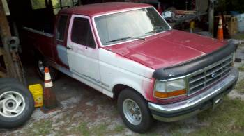

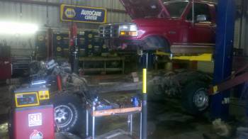

Post by steve-oh »
Pulled cab off swapped in a cleaner frame, removed 79 dana 44 front, new vavle cover gaskets and oil pan gasket, new poly body mounts...

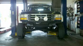

Post by steve-oh »
Heres what it looks like now. Waiting on fenders and new bed has to be finished

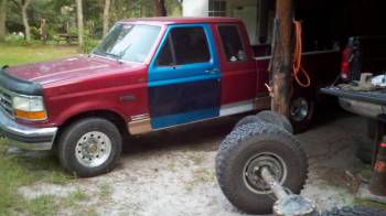

Post by steve-oh »
Some new rubber as well and back to the factory wheels, for now

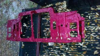

Post by steve-oh »
Core support is ready
