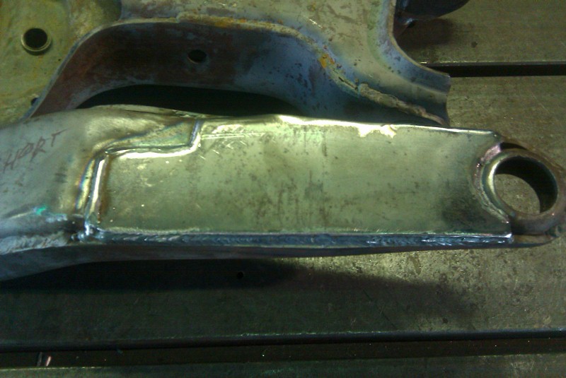

Cut and turned TTB from Solo motorsports,

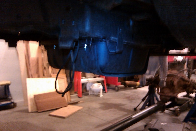

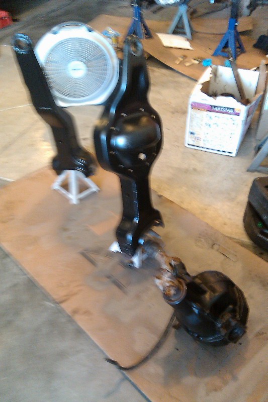

I broke the project up into two "phases", one where i took the bed off and used a chassis paint product and replaced some brackets in the rear, as well as stuffed a bronco gas tank in the rear. i had to make a 1.5" drop bracket to allow for fitment, but turned out pretty well. I'll try to get a better pic. i also took the dumb ass body lift off!

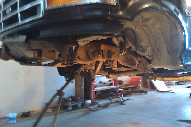

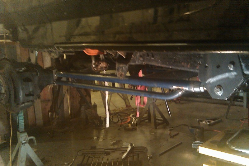

i need to get some more pics of the front end , but i am pretty much done. really all i need to do is weld it all up.

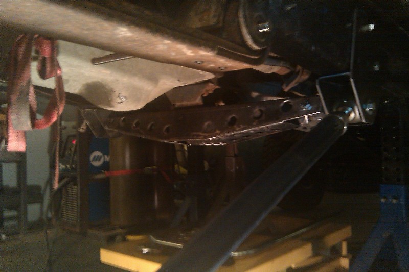

everything painted with the chassis liner another pick of the tranny x-member tied into the radius arm brackets and not to make you guys jealous but the postman is bringing these guys next week

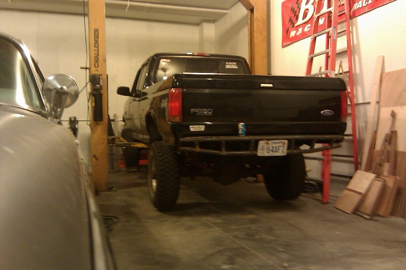

picture of rear bumper. need to cap the end, not sure what to do yet.

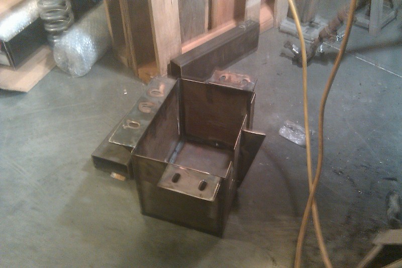

this is my battery box for my optima red top, i am mounting it uder the bed just in front of the passenger side rear tire.
angle is weird so the gas tank looks really low, plus i have the front end up pretty high. smart phones are awesome but take terrible pictures

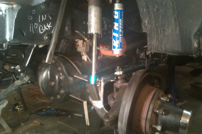

setting up coils, with temporary shock hoops
front view
radius arms, there not done yet, only tacked up.
i'll stitch them up and when everything is done and looks good, pull it all off, weld it all up then add some dimple died plates.

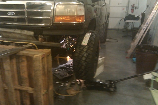

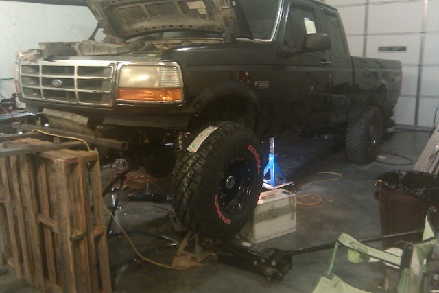

got my new tires 35's
i am going to need fiberglass quicker than i thought

Re: Go Fast ( presented in f250 HD)
Go back to the Alcoas, and you wont need the fiberglass, those wheels look pretty wide, and with a pretty high offset. That is likely causing that tire sticking out so much.
