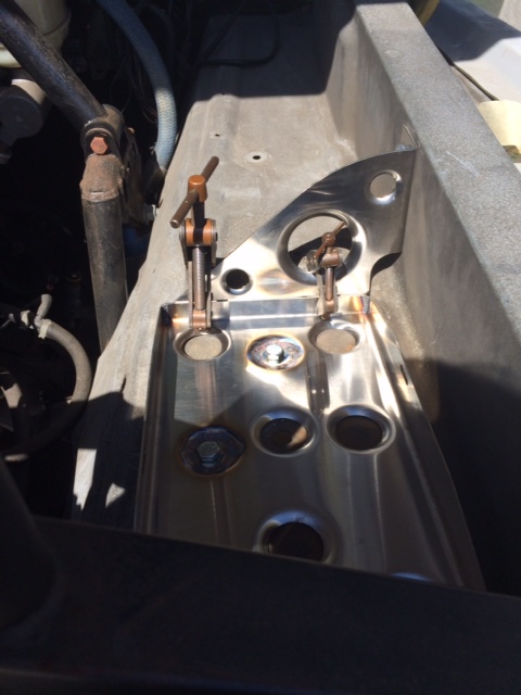

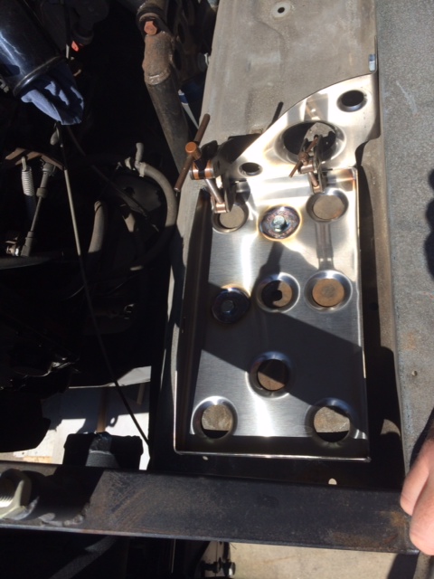

Contorted lower radiator tube finished up
Also welded up the batt. boxes, although now part of me is thinking I should just set up a dual batt. box on the driver's side like I've seen some guys do.
I'm thinking I'll just run 1 batt. for now and put the BHAF where the pass side box was. I can then build a 2 batt. box & add a second batt. later on if I want/need.
Time to get to finishing up the support brackets for the AMP step mounts, running the e-brake cables & then either looking at the twin stick shifter setup, headlight mounts, fuel line run or the air intake. So many "little" things left to keep plugging away at!

Bitchin!ChaseTruck754 wrote:Contorted lower radiator tube finished up

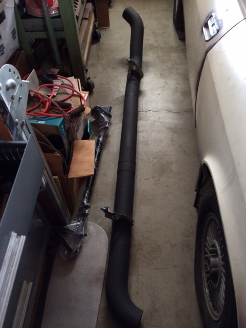

No clue. I'm getting closER, but still lots of little stuff to do. Been doing a few small things, but not much worth mentioning or posting pics of. Stuff like trying to work out the e-brake, brackets for my AMP steps, etc.Rmc wrote:Very nice man. How long till she turns over? Looks like your getting pretty close now.
I did paint the exhaust black with high temp paint though. The one section of aluminized steel that was a different color was bugging me. Plus this makes it hide a little better

I love how you are running the exhaust, very slick Battery boxes double slick!
