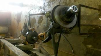

Rebuilding front axle today, ball joints, bearings, seals and brakes

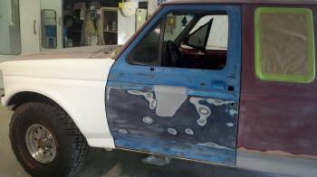

Sand, sand,sand......
Re: 95 f150 4x4
Nice work........
Pop the chrome trim around the windshield off.....it just has little clips on it, will help for a better paint job.

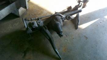

Had a set back, wrong ratio in rear end from the frame donor truck, so went ahead and put a e 150 8.8 rear end in, gained 1.5 inches gonna be close with the pulled bedsides
