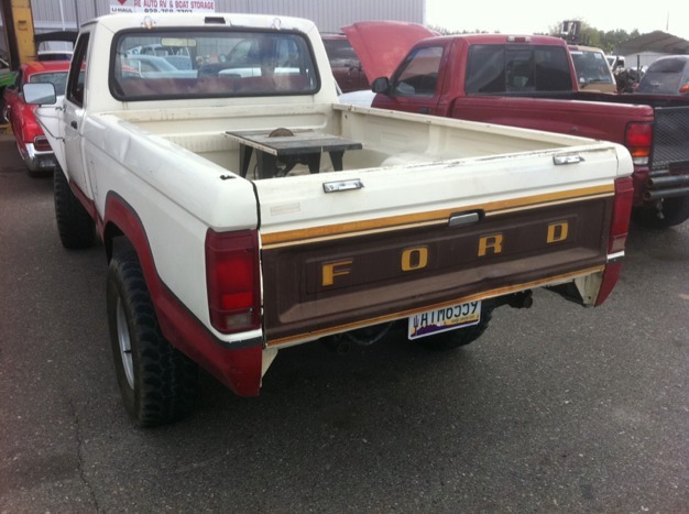

Got a sweet tailgate for $5.43 at pick apart today...

Re: Philofab's shop Ranger
I think you should base the color scheme off the tailgate.
Haha, full on retro?

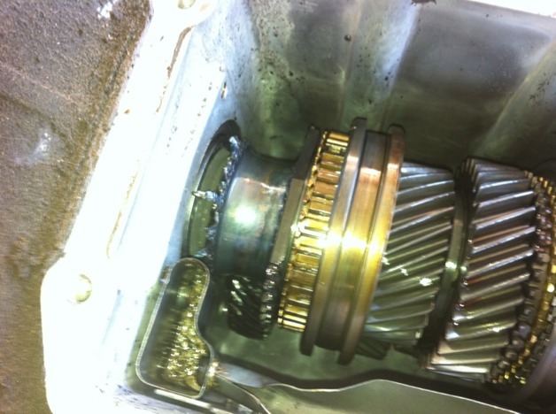

Went to drive the ranger to California yesterday and only made it 80 miles or so. Transmission couldn't handle the power of the 2.3!!!
