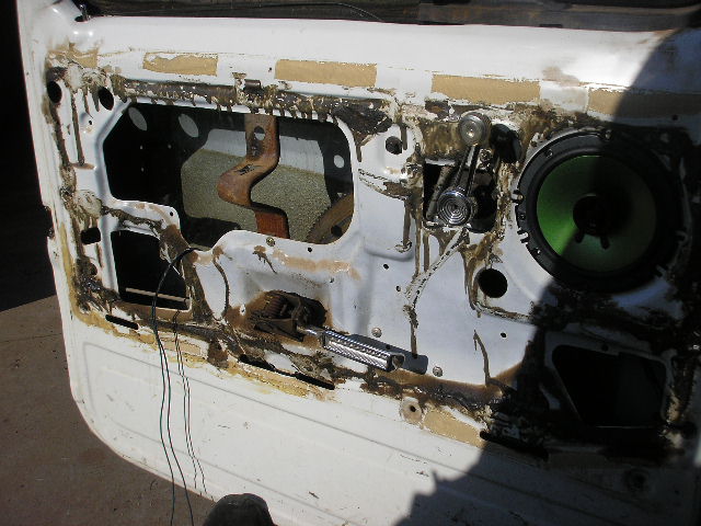

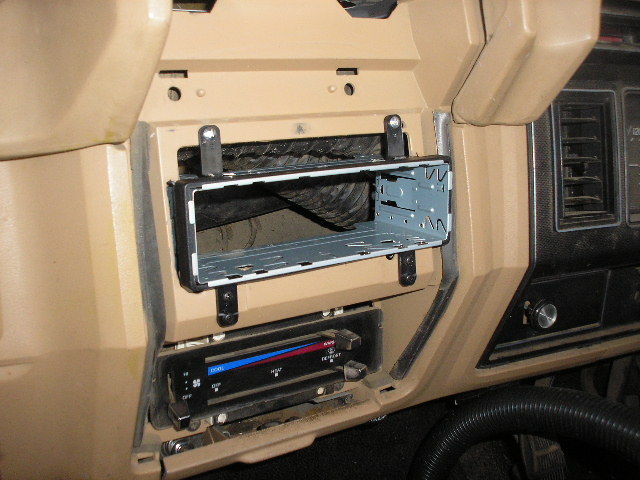

The door locking went in without a hitch, the new radio and speakers sound great, and now I can wind up my window without swearing and having to pull it up at the same time.
LH door view:
Radio holder fitted up:
Not sure how the doors are in US trucks, but these, while rust free thank god, are really flimsy. If I got hit in the side in a traffic accident, I will be a goner. :roll: Emailed John at Autofab too, about the lead time for all the fiberglass... hopfully I can order that next week. Once it arrives, I will tackle the bodywork and get her looking spiffy, then, its on to the suspension and 4WD conversion. Oh, and get this, I cant buy new wheels for it here anymore. Any wheel in 5 on 5.5" has to be specially made up.

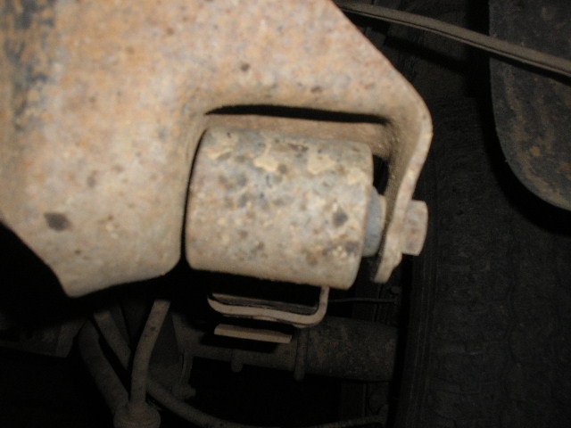

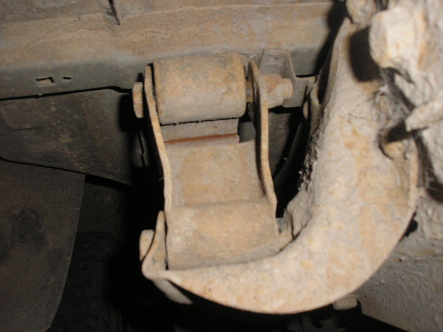

This evening coming home from work, I noticed the rear end didnt seem to want to track right, and was bouncing more than usual. A close inspection found this:
Shackle bushings are stuffed, bolts have worn into spring eyes too:
Chassis hangers have been overtightened and are now useless, I will have to replace them:
Re: Rod's 84 BabyBajaF100

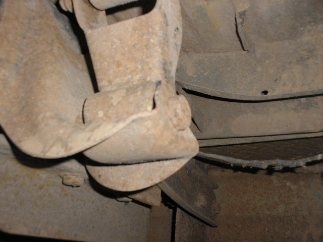

Front spring bushes and hangers are toast, too:
At some time in the past, the springs have been re-done, with 2 extra leaves. The problem being the sharp front edge of the new second leaf has cut into the radius of the spring eye, so the main leaves are also RS. :evil:
Looks like my fiberglass is going to have to wait now, I will have to fast forward the suspension rebuild. :( :roll:

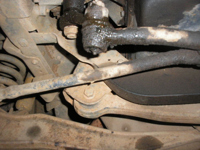

On a brighter note, check out how the aussie steering is positioned compared to the beam pivots:
Less bump steer here :D

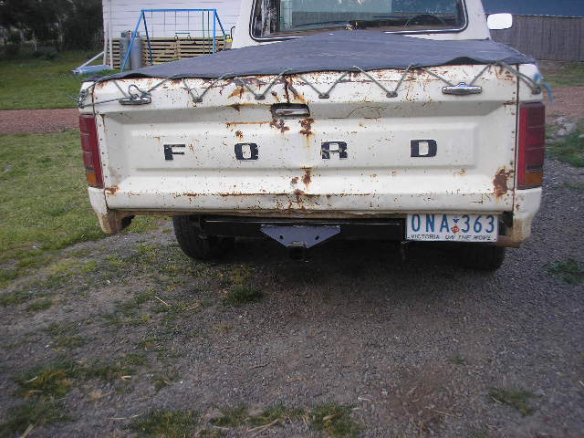

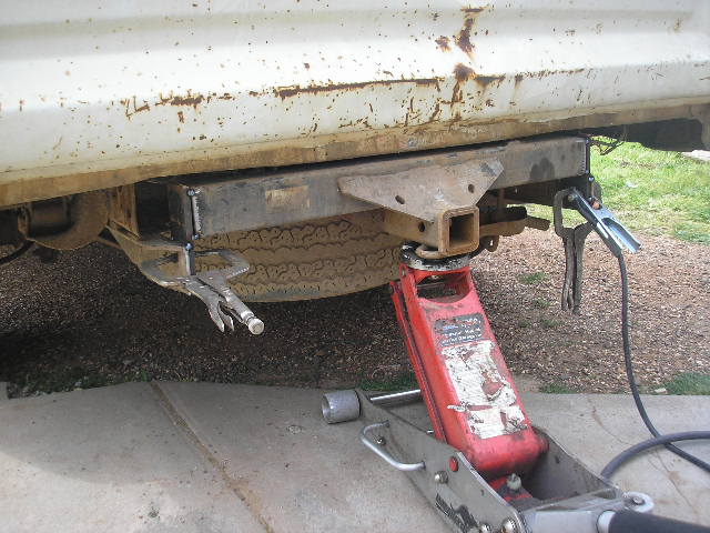

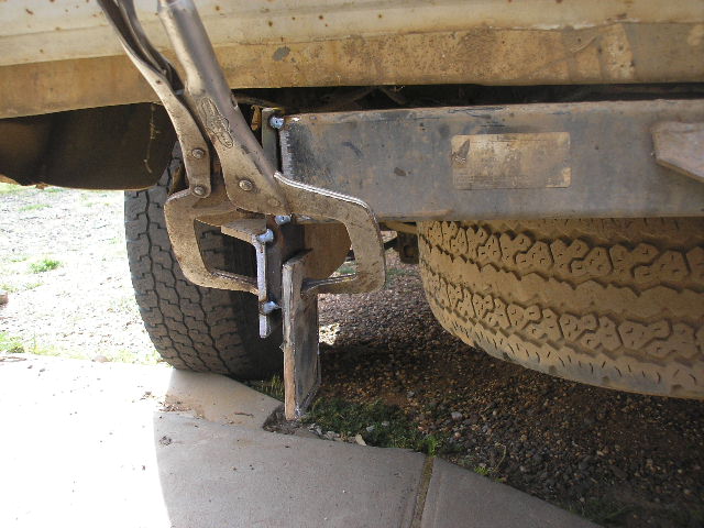

Today (Saturday) I decided to modify the hitch. After removing the heavy-ass factory bumper it was plain to see why the thing dragged at any opportunity. It took some effort with the rattle gun and WD40 and lots of swearing to get all 6 bolts off and land the thing on the ground. I then cut off the mounting brackets and removed the drop plates. I re-installed the mounts and clamped the new riser plates on then tacked the hitch tube back into place 5" higher than before:
Note the difference in height with the old drop plate clamped on for comparison:
When I was satisfied it cleared everything, I welded it up on the truck, then removed it to finish the welding. I'm not fussed about painting it too good right now, as it will get sandblasted with the back and front bumpers once I make them up. The finished result:

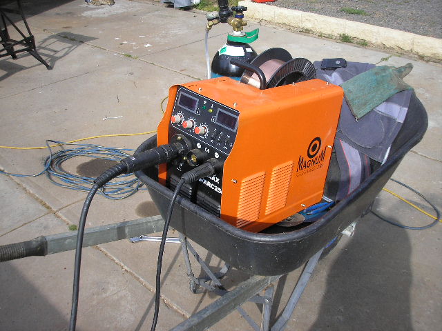

My little MIG welder, sitting in its outdoor trolley :D
This thing is fantastic, I can weld body panels perfectly or 5/8" plate without a problem. It was the only welder I could buy in the 250 amp class that could do 40% duty cycle @ 250A. All the others were 15% or less. I cut out my bumper mounts on the cutting table at work yesterday... next weeks lunch times will be spent bending up the tubes I want and I will fit and weld them up at home.
