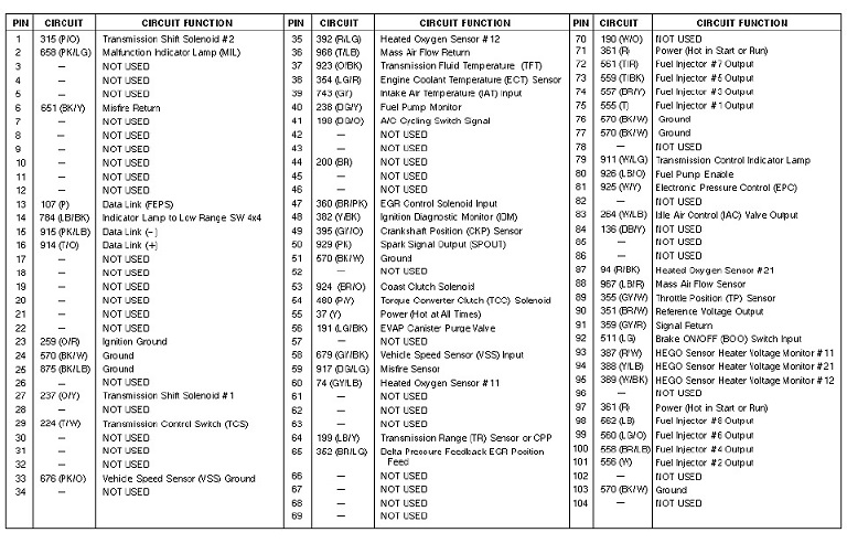

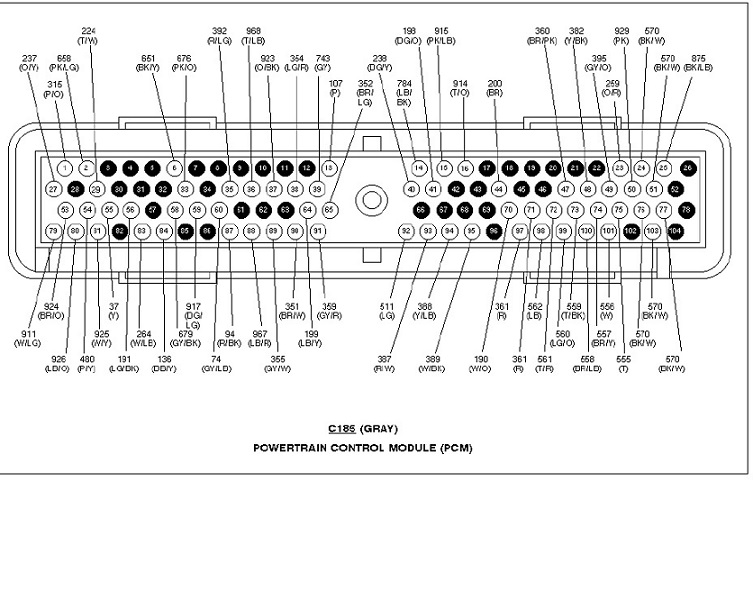

Wanted this posted so I could always have it:

What's years is this good through?

I'm guessing '96 OBD II, given the number of ECM pins.RyanDS650X wrote:What's years is this good through?

My 95 truck and 96 bronco have 96 wiring and 96 OBDII computers. Posted this so if I lost my phone, or wanted my own easy to find reference material. I think I’m going to get these printed off and laminated so I have a hard copy reference.

If you print some off in higher resolution, i would love to have a laminated copy.VintageIronFab wrote:My 95 truck and 96 bronco have 96 wiring and 96 OBDII computers. Posted this so if I lost my phone, or wanted my own easy to find reference material. I think I’m going to get these printed off and laminated so I have a hard copy reference.

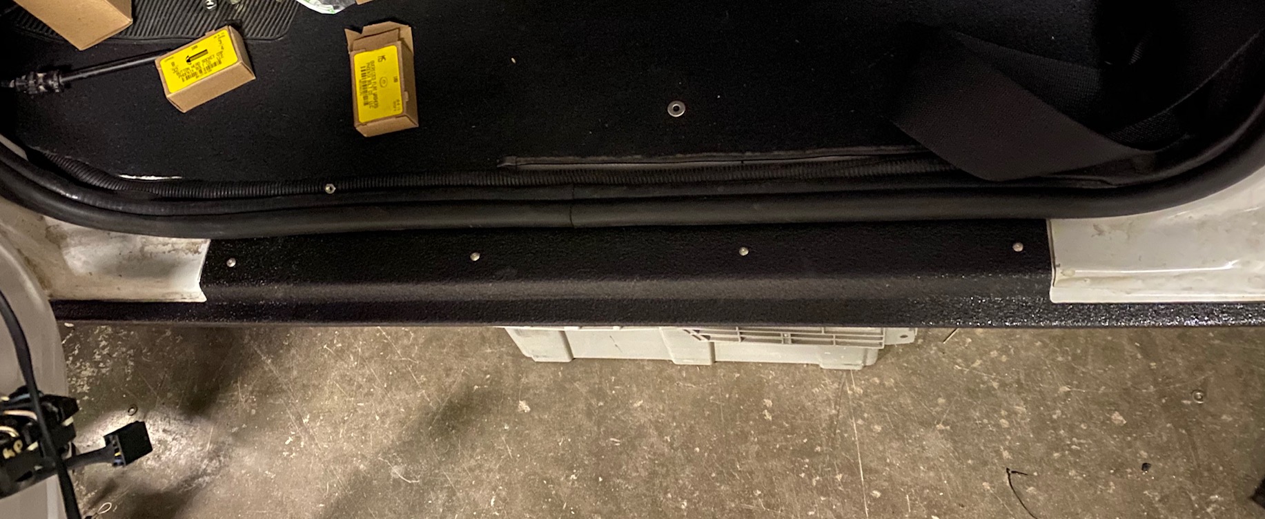

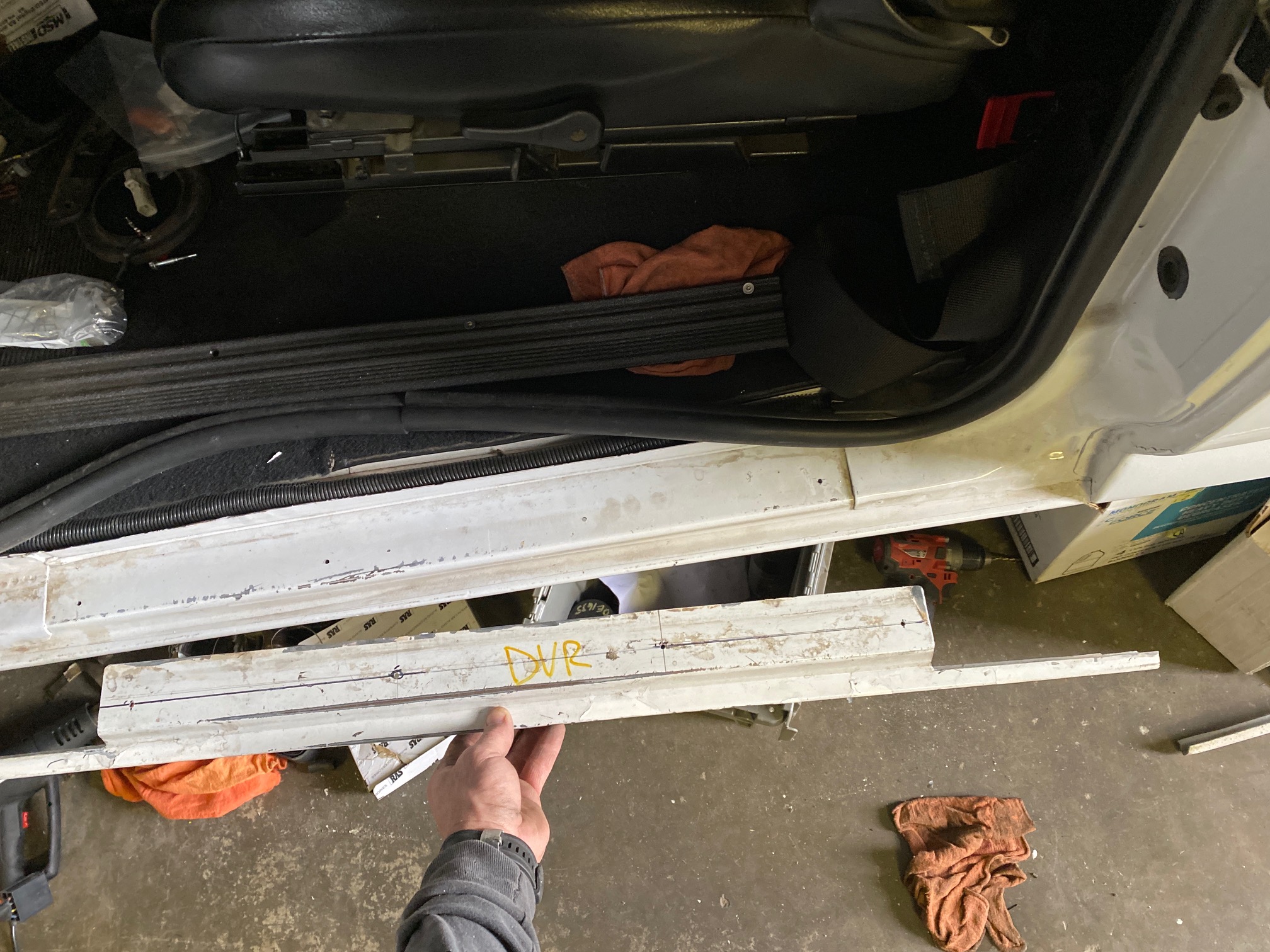

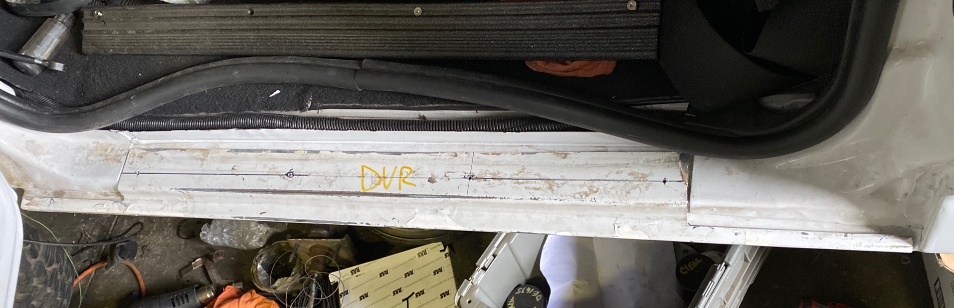

Door sill protectors made out of JY sills I’ve cut out, cut down, will finish in Linex and attach via some #10 SS buttonheads.

Nice! I've never even noticed that spot. I bought replacement plastic trim in billet aluminum. Hopefully they hold up.

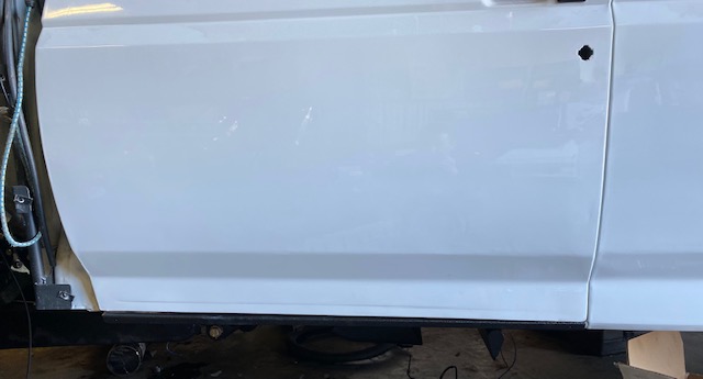

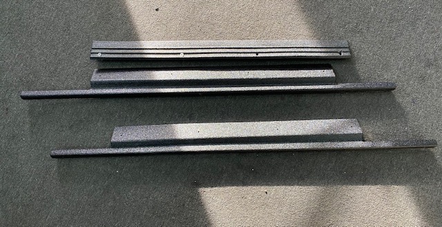

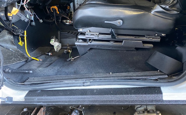

Got the door sill protectors aback from Linex and installed. It’s just nice to not feel like you’re crunching a painted surface when going in and out. Highly recommend this method!

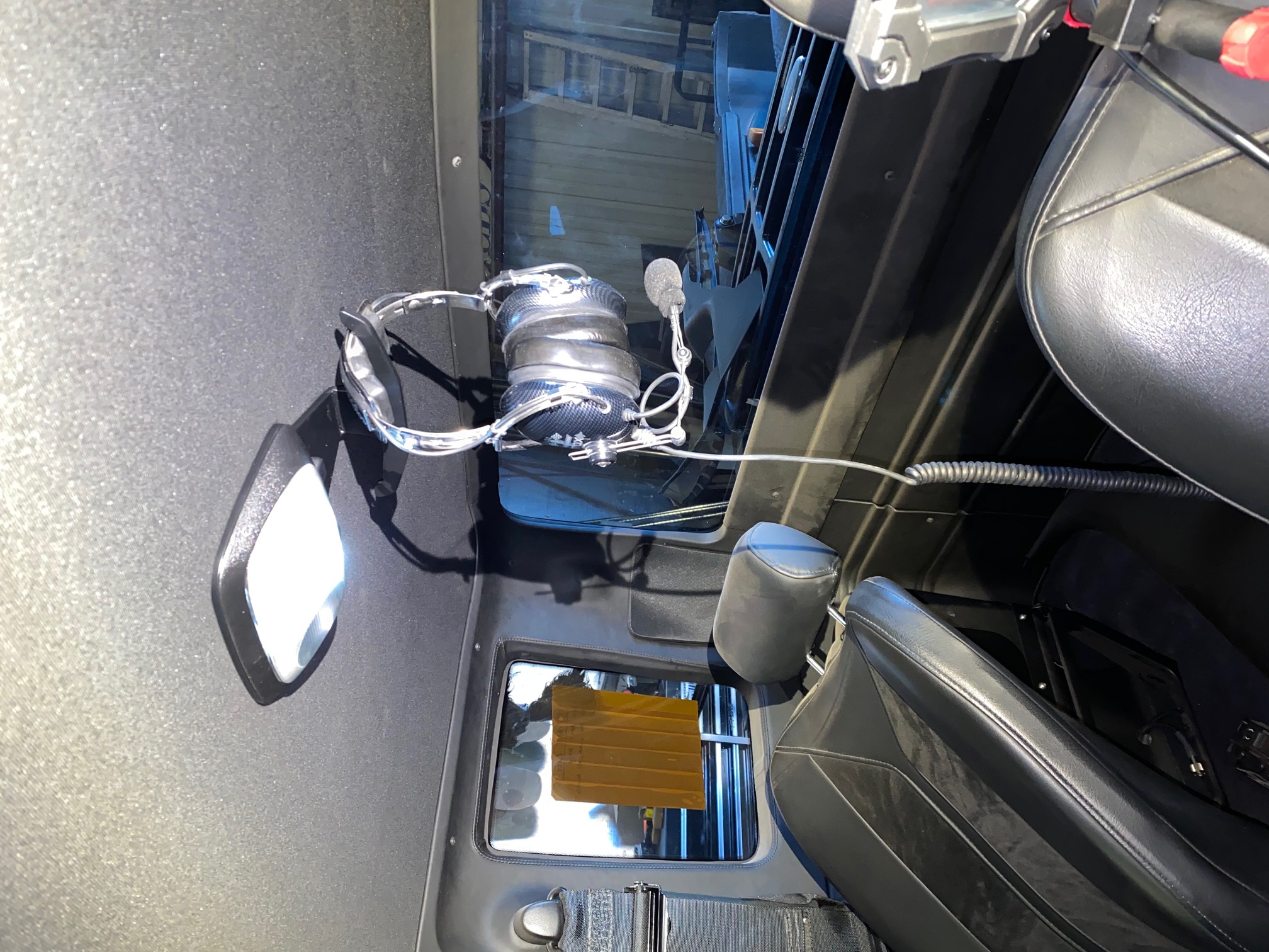

Needed a clean/convenient bracket to hold headsets. Made the bracket out of 1/4” aluminum mainly to keep it from looking spindly and really light in weight. Powdercoated to match of course and held down with a factory Ford light fitted with some LED’s. No obstruction with the view out back (without headsets of course) and is about 14-16” away from your head.

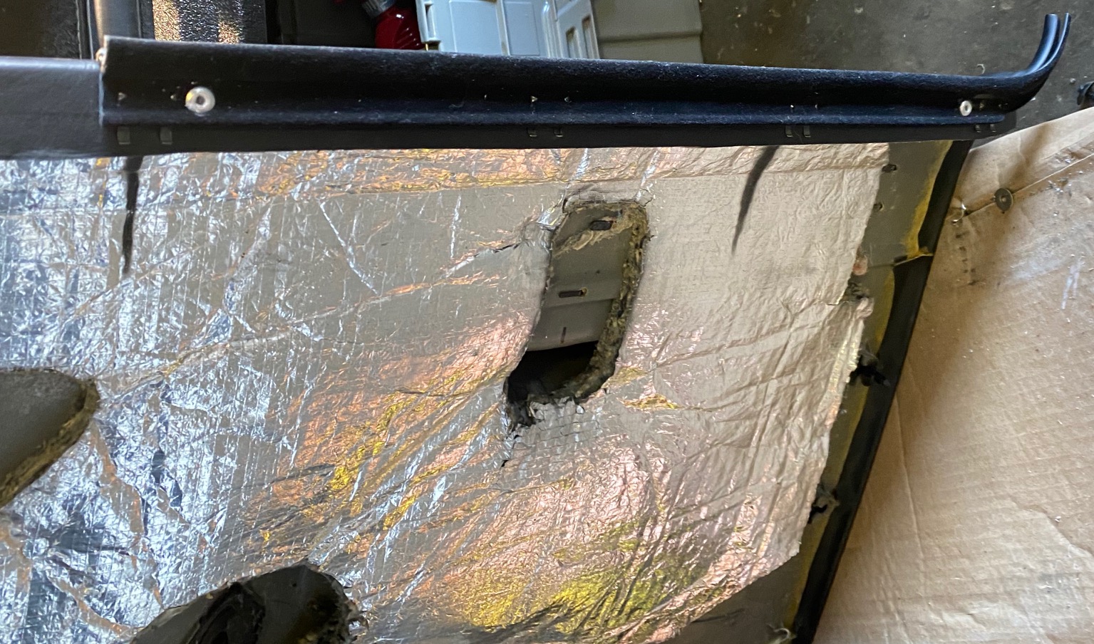

New window sweep install fix—
New window sweeps are a nice update/upgrade/fix but the NOS ones don’t exist and they probably wouldn’t fit due to the 25 yo old door panel slots. So I got tired of them not fitting and just made a couple sporty oblong washers out of some scrap- stainless would be perfect and pop riveted them in place. Fits brand new tight and won’t come loose again!

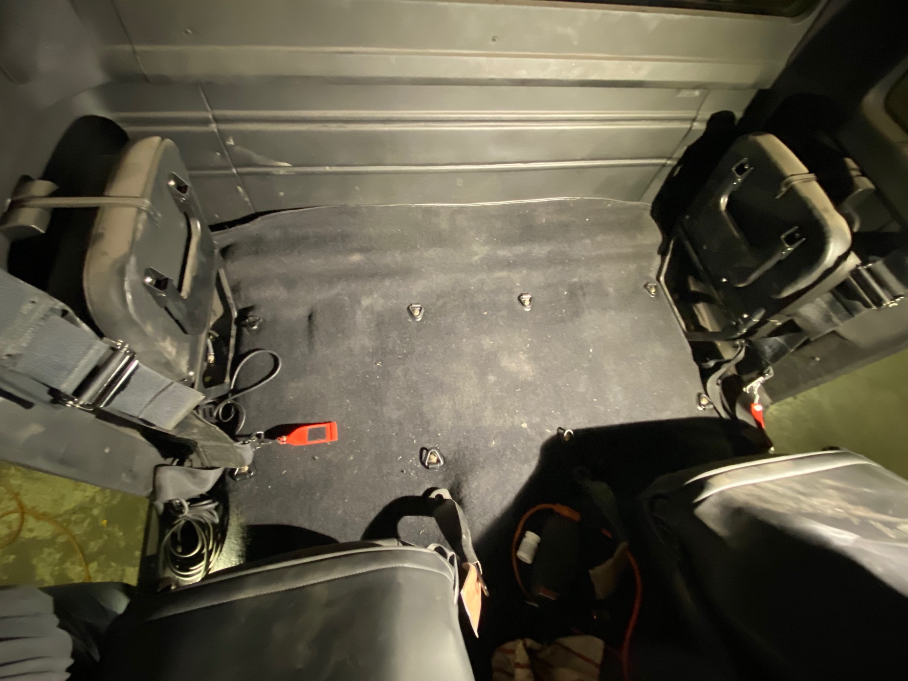

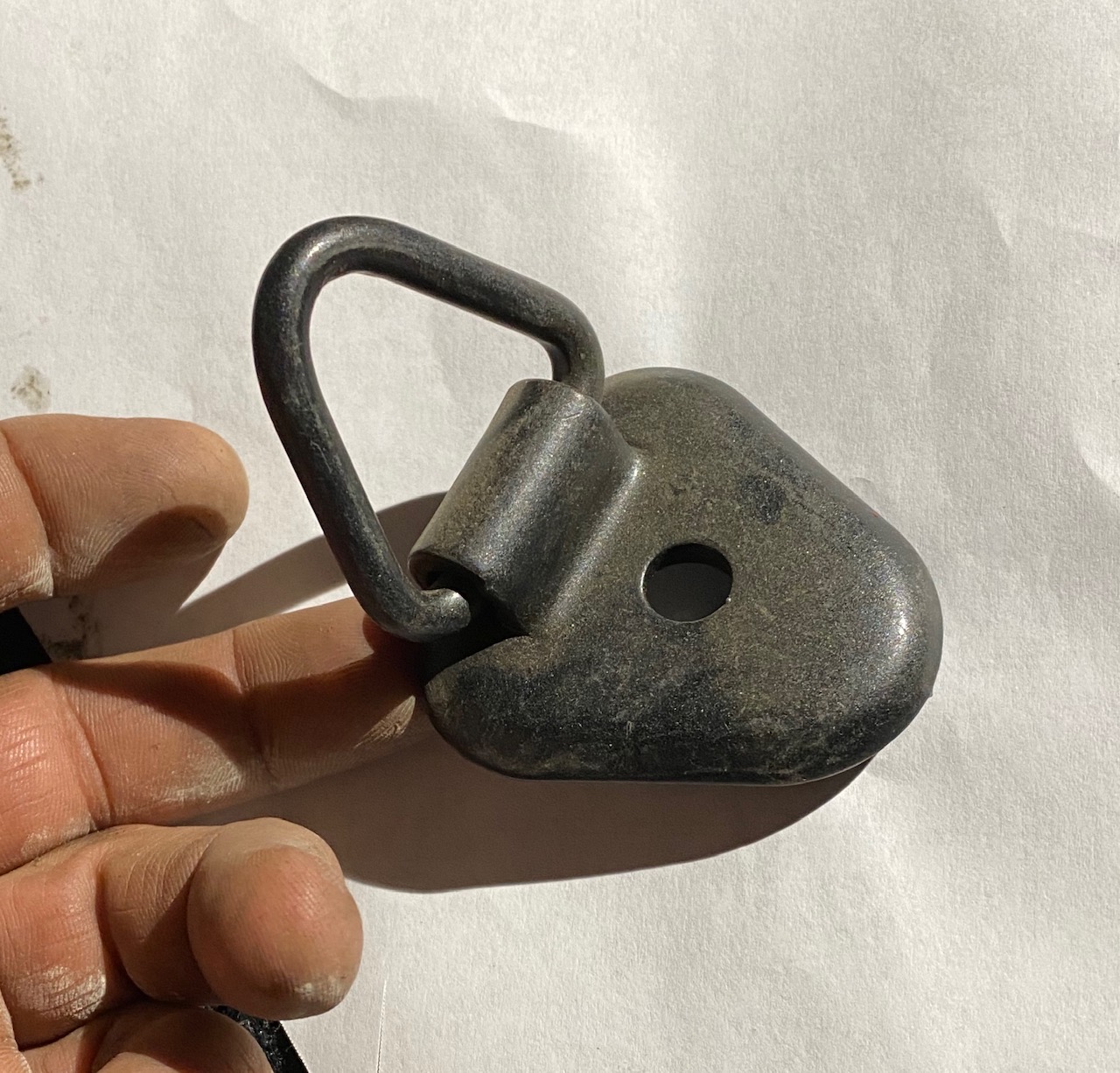

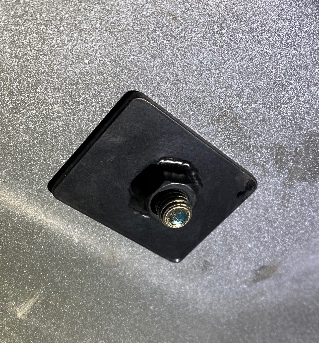

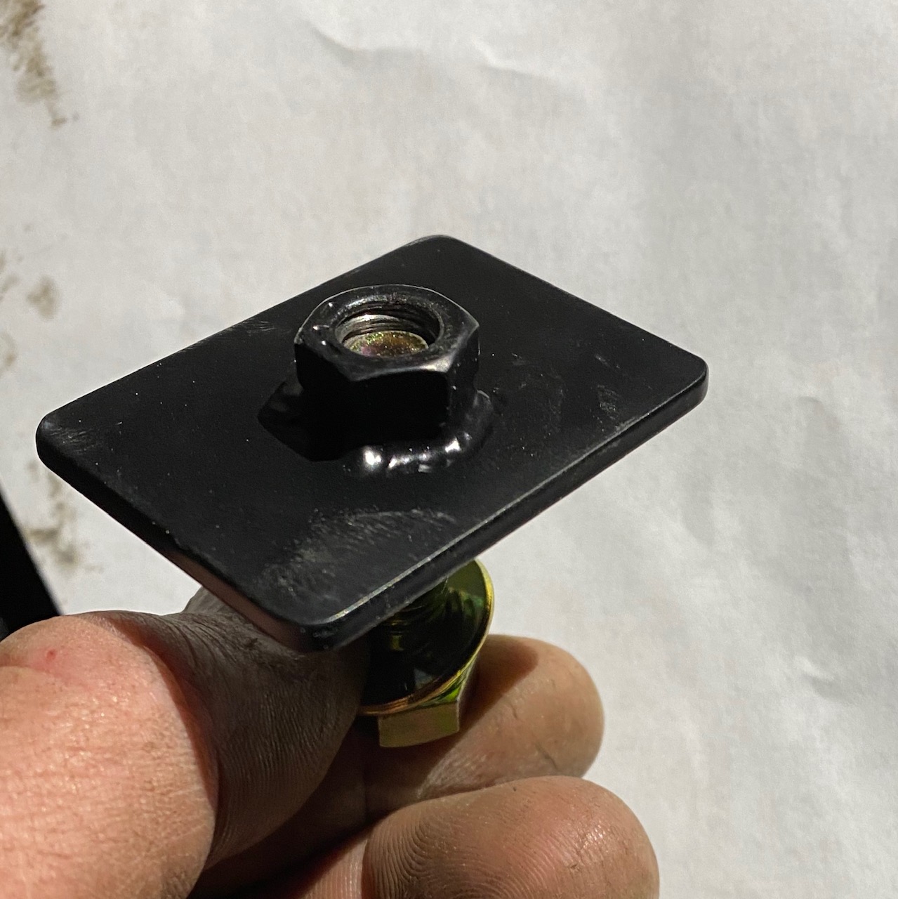

Finally installed all the inside can tie downs ---- no floating stuff inside the cab! These are from the 2000-ish Chevy Blazers (S-10 size); they are HD pieces that lhave a hole for a 3/8” bolt which is way big/strong enough for the application. The “washers” turned out pretty well and should give a nice secure backing no matter how aggressive the driving gets. All got powdercoated satin black lol!
Those are factory F150 jump seats btw.
