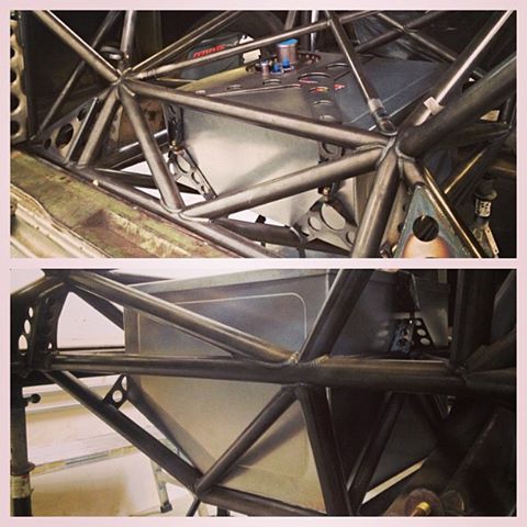

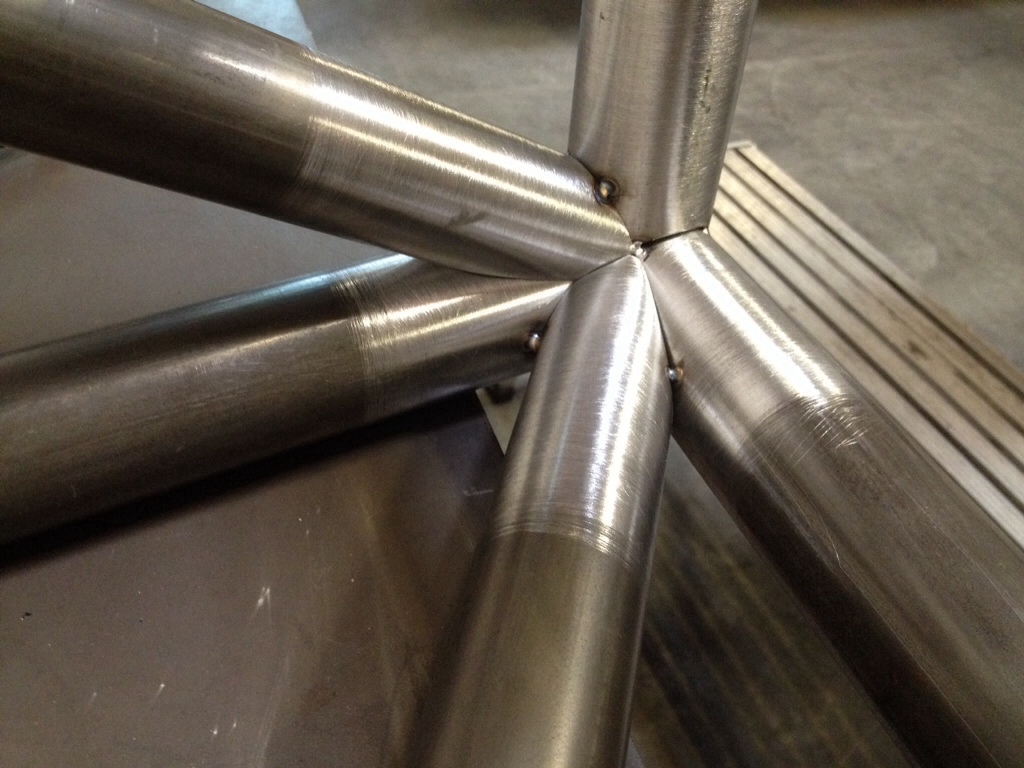

Super clean welds... what a great project! Look forward to following this build.

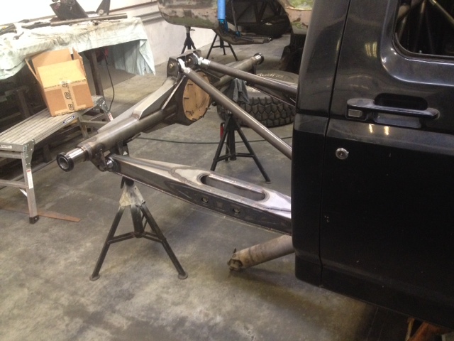

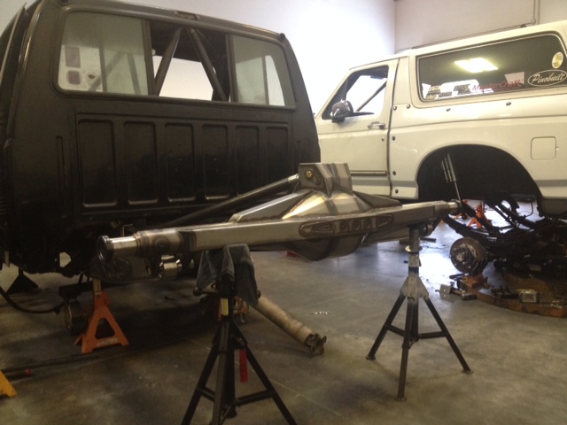

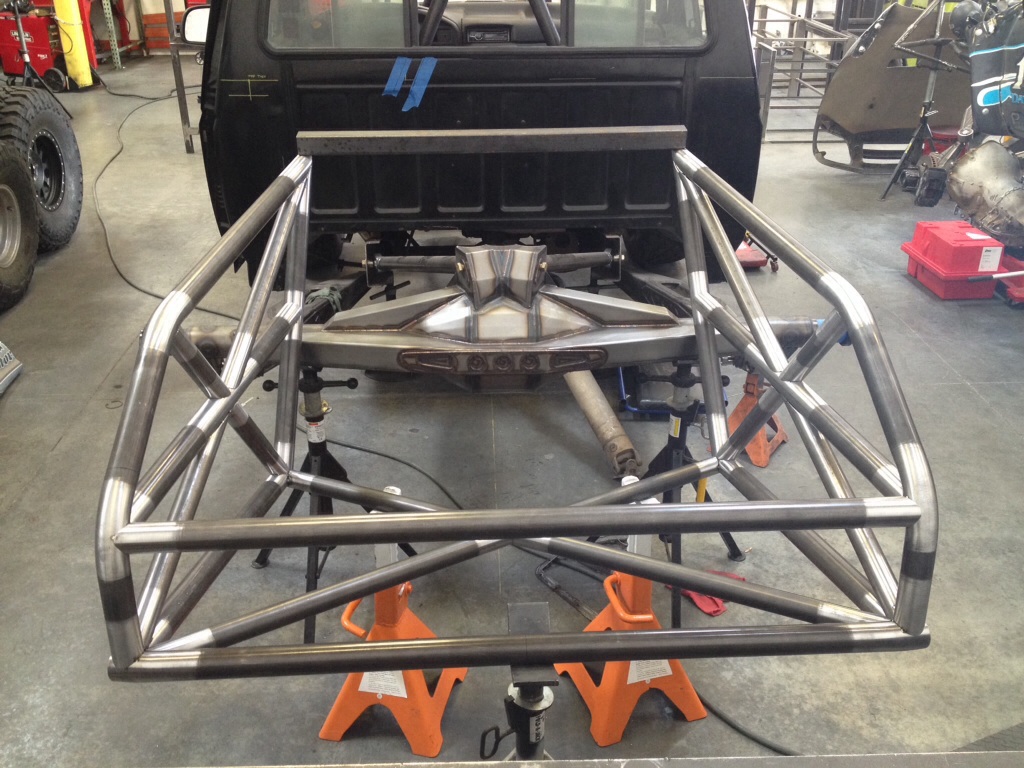

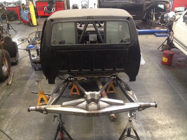

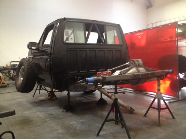

got the rear end mocked up and cyclying, in the process of desgning the backhalf now. Expect some big updates soon!
Re: Black Lightning
Liking the progress, what rear end is that? Specs?

cs_drums wrote:Liking the progress, what rear end is that? Specs?
it is a blitkrieg housing 3.5 tubes full 4130 tig welded, really nice part!
Ill get some some pics of the white bronco or maybe have the owner start a thread, its a awesome truck, i have been working on it for the past couple months. Has everything you could want minus links.

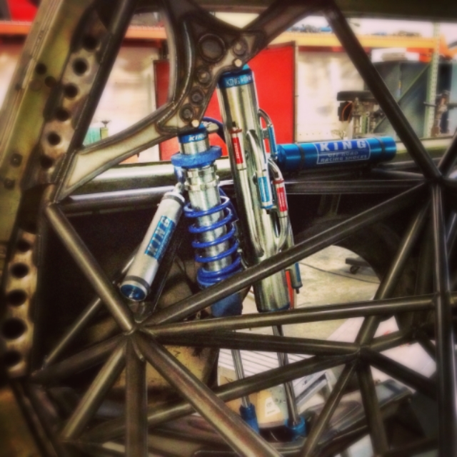

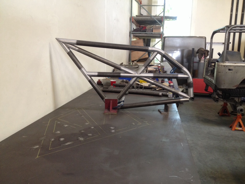

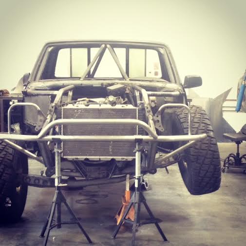

Here are some more pics, I drew up the back half the other day, real excited to get going on it. front has 13" of up travel, will probably bump it lower for ground clearance reasons. The rear has 14" of uptravel at ride height, the truck sits 4-5" taller than stock with 37" tires

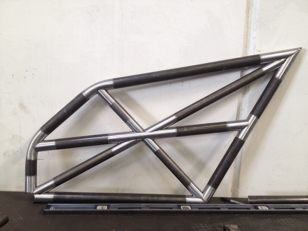

more

That one long continuous bead I think on the side of the frame is absolutely beautiful. Do you worry about serious warping with a weld that long and nonstop. If it's not continuous the transitions are literally perfect.

VintageIronFab wrote:That one long continuous bead I think on the side of the frame is absolutely beautiful. Do you worry about serious warping with a weld that long and nonstop. If it's not continuous the transitions are literally perfect.
Thanks, no worries about warping, there is enough structure to keep things from moving. And yes, i try to do as little starts and stops as possible.

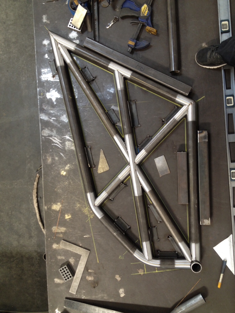

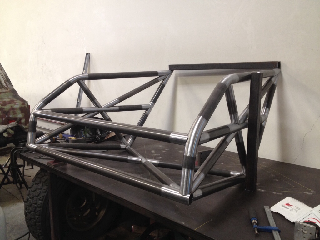

Finally got to start on the back half last week, 2 days in a and ran out of material and our supplier had to order more so hopefully more updates next week
