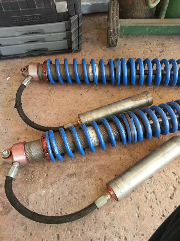

The coils are 600/700 that's probably to rough what do you guys think
Re: 95 F150 4x4 " RagnFRD"
Try em you never know. Id say probably but hell youve got em try em out.
Re: 95 F150 4x4
I believe there way too stiff, I'm thinking 350 over 400 range. But I ran 400 over 500 till I got what I needed for mine. Run them and see.

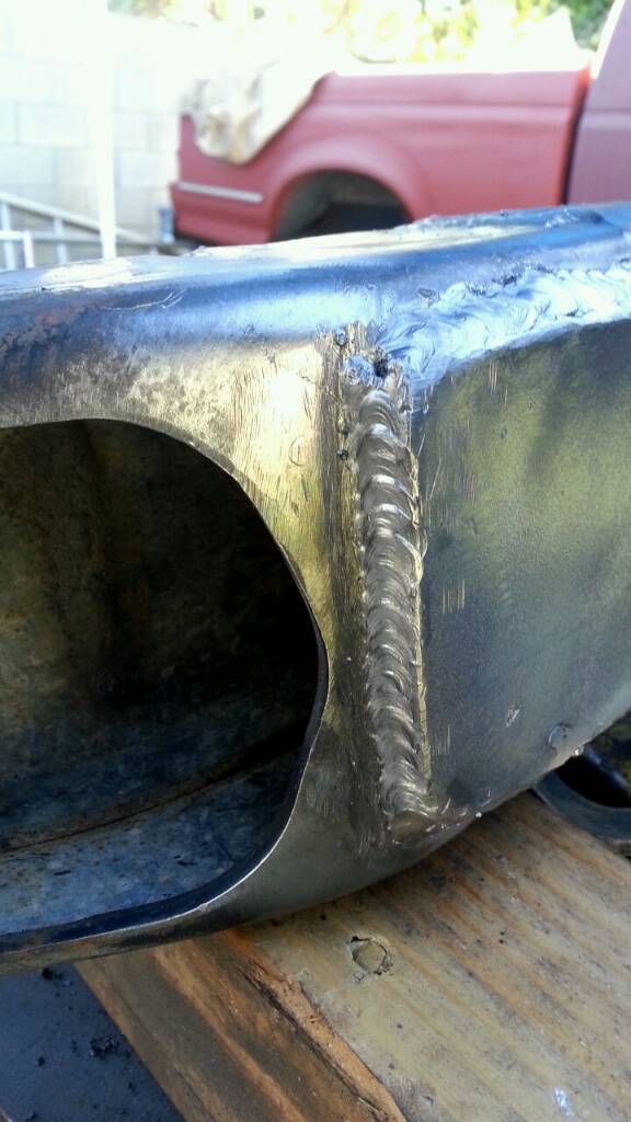

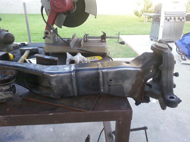

My dad finished up the extensions I thought they came out really good

Finished the passenger beam gonna work on the drivers side tomorrow then gonna plate them
Re: 95 F150 4x4
Looks very nice.

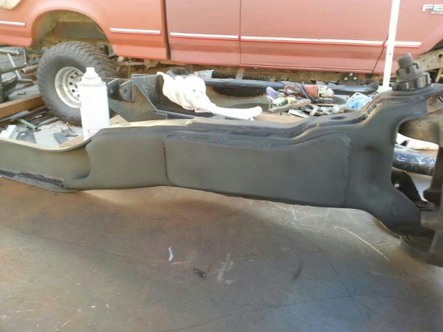

Got the plating done on the passenger beam the welds came out nice
Re: 95 F150 4x4
How thick of plate is that? Looks like 1/4 inch. Definatly strong.

Post by JA_gonzalez »
Yeah used 1/4 just to be sure it holds good haha

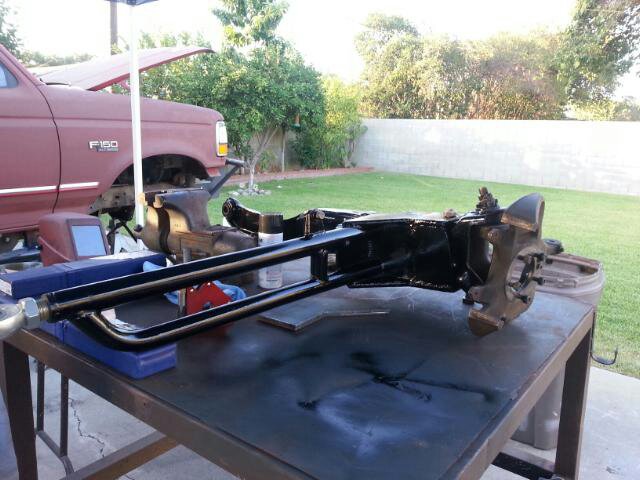

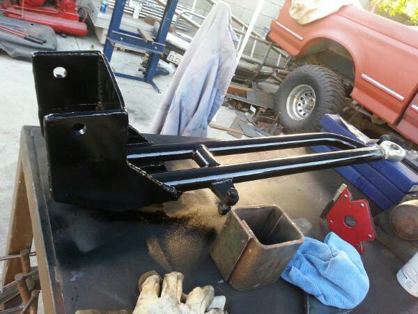

Finished the passenger beam and the radius arms since we cut before the hole we had to adjust the radius arm a bit haven't worked on the truck my dad accidently smashed his thumb working so can't get any updates going

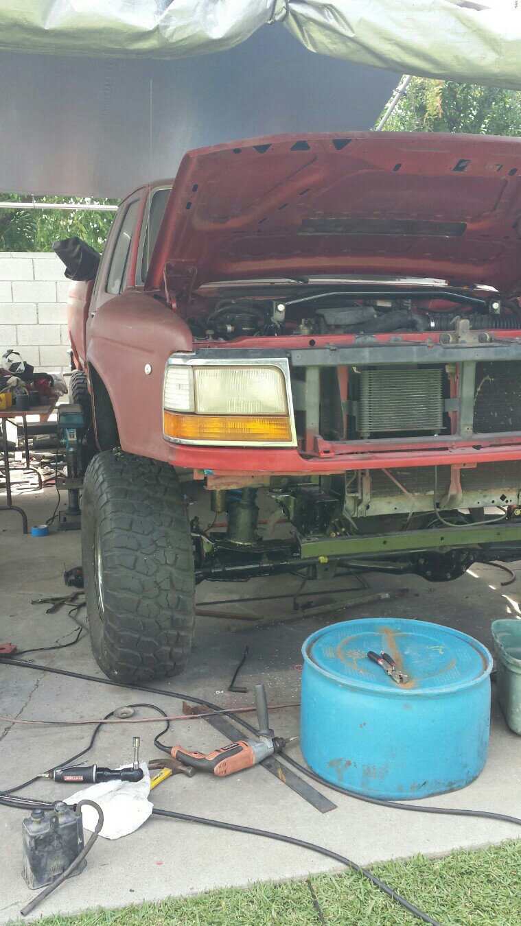

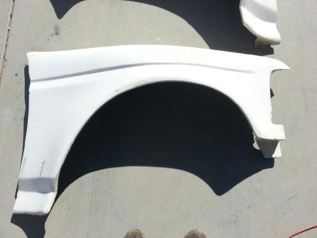

Finished the driver beam just need a couple of adjustments next is the engine cage so I'm picking up some dom tubing this week I did pick up some glass yesterday guy didn't know who made them but they were in good condition so I didn't care I mocked them up I just need to take the inner fender off

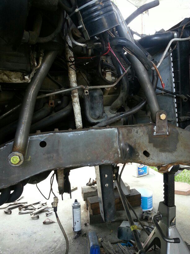

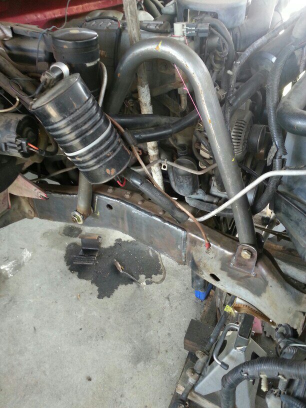

Finally had time to work on the truck some more this month We ran into some trouble trying to bend some pipe and couldnt do it right on my harbor freight bender luckly my buddy works at a muffler shop so he did it for us I finally welded the plate to the frame and we finished one side of the engine cage

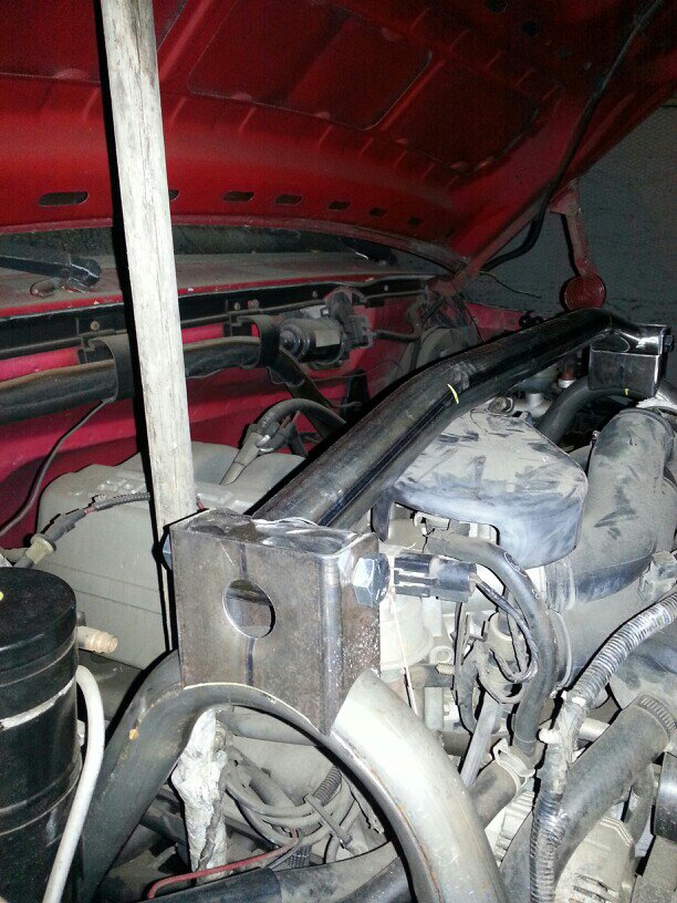

I mocked the cross over bar today going to weld it all tomorrow

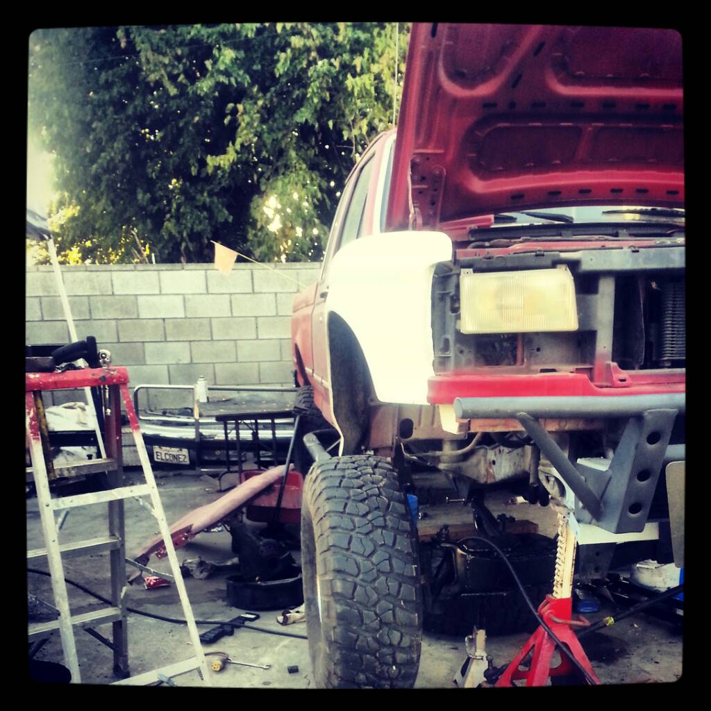

Got a lot done these past months it's coming down to the last bits mocking up the glass and getting it ready for paint[attachment=-1]uploadfromtaptalk1405203342166.jpg[/attachment][attachment=-1]uploadfromtaptalk1405203358975.jpg[/attachment][attachment=-1]uploadfromtaptalk1405203375077.jpg[/attachment] [attachment=-1]uploadfromtaptalk1405203317420.jpg[/attachment]
