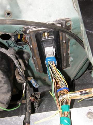

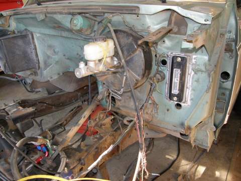

This is the ECM intall into the firewall. I ended up mounting it where the stock F150 and F250's were located. The harness wire length was perfect and I found enough room to build a mount and seal it.
ECM
ECM
engine bay wiring 004.jpg (37.56 KiB) Viewed 2001 times

BajaF250 wrote:This is the ECM intall into the firewall. I ended up mounting it where the stock F150 and F250's were located. The harness wire length was perfect and I found enough room to build a mount and seal it.
Another job well done, Tom!

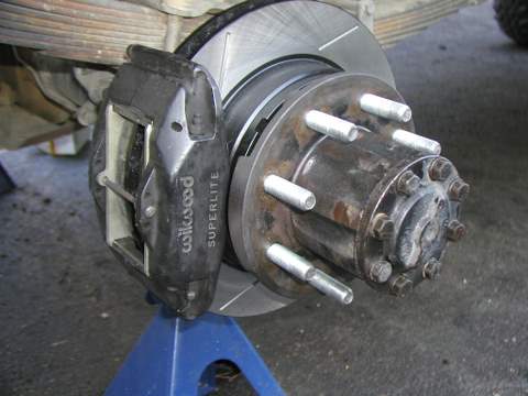

I've added an adjustable proportioning valve to control the rear brakes a little better (since I converted to rear discs ). I also added 2lb valves inline in both the front and rear brakes to keep the brake pedal nice and high. I'm using a Wilwood master cylinder which works quite well.

The Wilwood works great. I had an Explorer master cylinder in there for a while, and I had to convert to the Wilwood, I didn't have enough pressure or pedal... It stops much better now. The above picture doesn't show it but I'm limited to a master cylinder that ports out on the driver's side. My coilover hoop is only about 1/4" from the master cylinder which doesn't leave any room on the inside.
I love the 2lb valves... keeps the pedal up high. No adverse effect. For my setup, it works quite well.
I love my Wilwood rear brakes...

Are those f250 front rotors on the rear? I reallllllly need to convert my 350 to rear disk and hydroboost before i kill a civic. lol

mkiefer wrote:Are those f250 front rotors on the rear? I reallllllly need to convert my 350 to rear disk and hydroboost before i kill a civic. lol
Hey Mark,
Yup, same discs on the rear as on the front! They work great! Makes getting parts a lot easier! Only one part number...
Re: BajaF250
BajaF250 wrote:Yup, same discs on the rear as on the front! They work great! Makes getting parts a lot easier! Only one part number...
Why does it look like there is a rotor, spacer, then hub? Anything tricky with the studs?

Nope, no spacer, just rotor and hub. Must be an optical delusion! :lol: The only thing special is that I have to drill the rotors to accept the 5/8" studs... 8 of 'em!!!

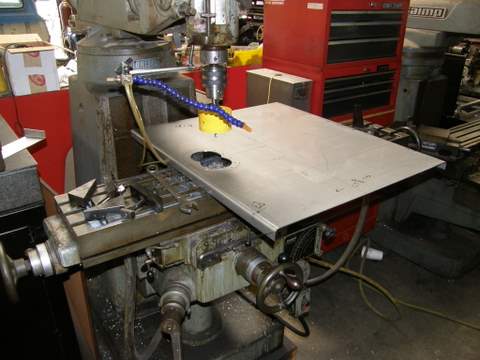

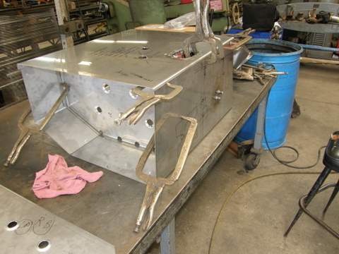

Got some work done this weekend. Although I didn't get as far on the tank as I'd hoped, I did finalize the layout and locations of all of the components. I got the pump/sump setup and mounted. And, since the darn thing is 14-ga stainless, it's a mother to cut and drill. I cut the access holes in the lid on the mill with plenty of cooling. I have the right baffle tacked into place but had to stop there. When mounting the fuel line connectors on the inside of the tank, I think I got a cold braze and I need to pressure check it before I go any further.

tank overall
tank overall
tank build 006.jpg (35.21 KiB) Viewed 1832 times

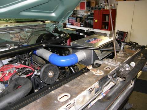

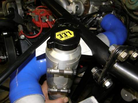

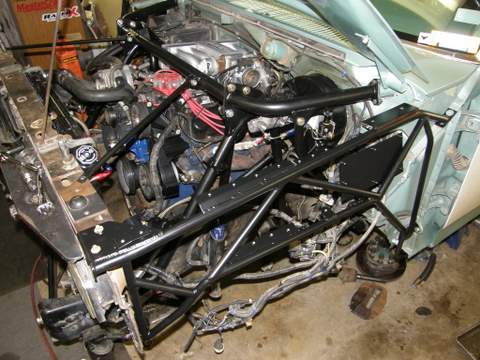

I also got some work done in the garage. I started building up the coilover supports/hoops and the engine cage supports. I mocked up the remote resevoir and made up a template for the mounting supports (not cut out yet, just in cardboard). There's a good shot of the core support after powder coating. Looks good all clean!
Well, it'll be a little while before I can get any further work done, I'll be on travel with my job for the next two weeks... ugh! I hit the road first thing in the am.
