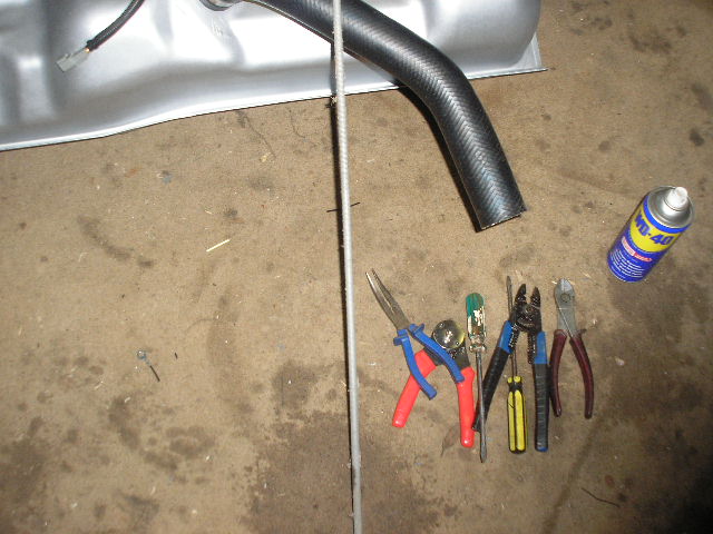

After a bit of pissing around this morning, I got started. It's been raining again, but most of this work can be done under cover. Drilled the holes for the fuel pump and mounted it up, but realised I now had two distinct problems: 1/ I'd mounted the pump on it's bracket the wrong way around, so I had to remove it and re-orientate it, and 2/ the filter was too close to the pump to get the hose on. Luckily, there were 2 holes further back that were on a slight angle and fitted the mount almost perfect, so I moved the filter back and carefully bent the mount to push the filter as far into the chassis rail as I could, without pinching the wiring harness above it:

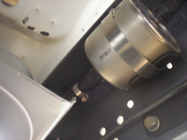

That made it easier the plumb the filter to the pump, so I used teflon tape on the pump fittings (they had a taper seat on the ends to match the pump tappings), screwed them in and fitted the hose. The hose was a tight fit, but a little WD 40 helped them slide neatly on. I then realised I didn't have any 2 pin Deutsch plugs left, but I fitted the pins/sleeves and connected them, insulating the positive wire for now until I can buy some on Monday (or salvage some from work at Cloncurry):

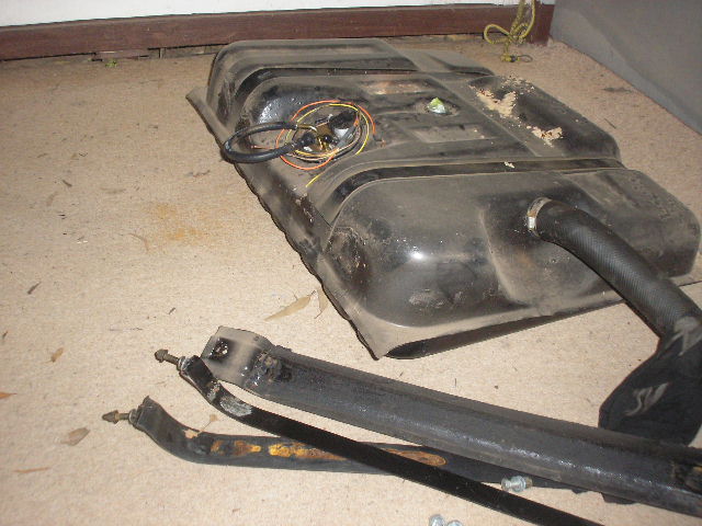

Fuel tank removed:
Plenty of space under there now, for the second propane tank:

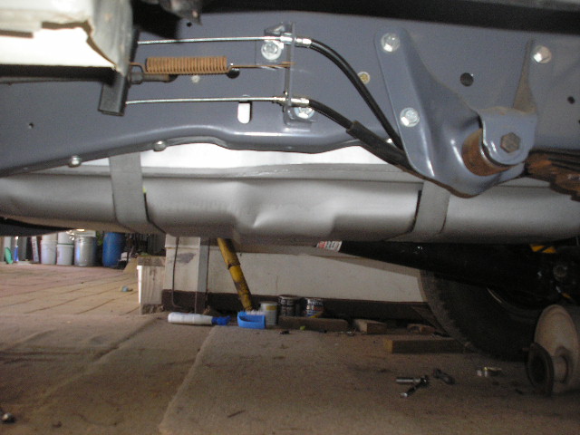

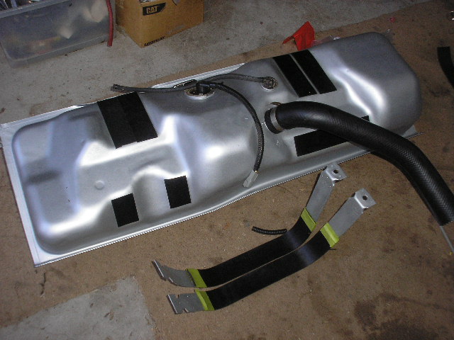

I then cut and cleaned the rubber strips for the fuel tank, then glued them on with contact cement:
This was the last pic I got before the bloody batteries went again. Anyway, the tank is under the truck, hanging in it's straps, with temporary bolts holding it up in position. Tomorrow I will get the correct bolts and use Ny-loks and panel washers to secure the straps, remove the muffler and connector to access the top of the tank and re-connect the sender, vent hose and fuel hose. While I'm out, I'll grab a jerry can full of premium fuel to add to the tank along with the fuel from the rear tank and a locking cap for the gas filler. Then I'll trim the filler neck from the rear and fit it up. Then, a leak test, run some fuel through the line at the carb to make sure it's clean, then fire it up and see how it runs with it's new supply system.

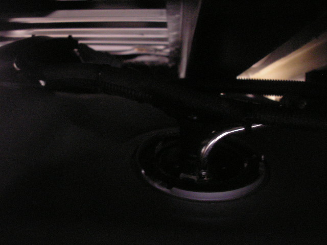

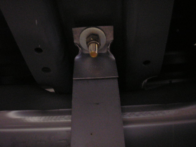

I continued on this morning, going out to get the correct bolts for the tank straps and an adaptor bush for the oil pressure sender that arrived this morning. Forgot to grab a locking gas cap and fuel while I was out, but did that later in the arvo. Anyway, I crawled under, removed the temporary muffler and finished tightening the the straps to secure the tank. It's nice and snug under there now. Un-did the canister vent line and re-routed that over and connected it, connected both the sender plug and the trimmed fuel hose to the sender. Tied up everything nice and neat and headed out to start playing with the filler tube:
View from outside:
Tank strap bolt(s):
Sender all done (flash didn't work):
Even though I moved the filter back, there is still clearance and I can replace it without losing my knuckles:

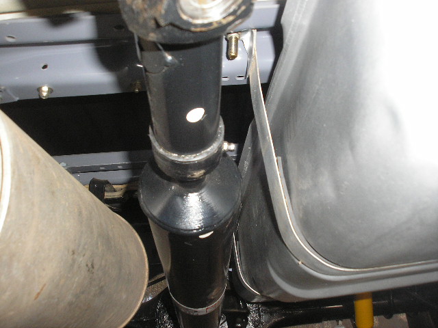

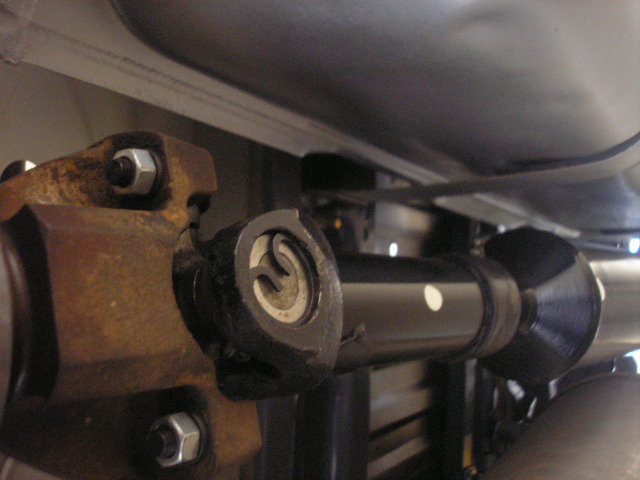

The t/case yoke clears nicely:
Plenty of room for the driveshaft, too:

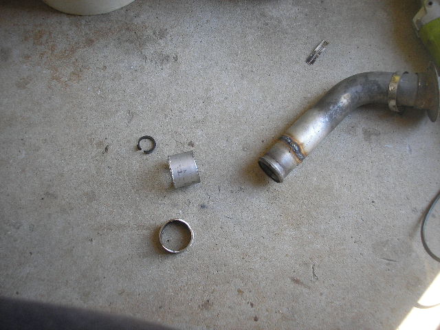

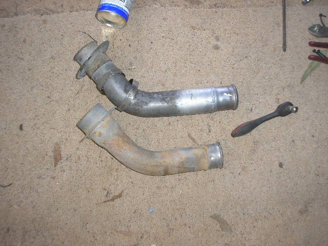

After some measuring and eyeballing, I cut the extended fuel neck back to it's original length, plus 1/2" to make sure it would fit. After welding the nipple back on, a quick clean up with the grinder and a coat of engine enamel silver over the welded area, I fitted it on. Went in spot-on for length and fit.
After trimming and welding:
The modified version and the aus original:
Installed:

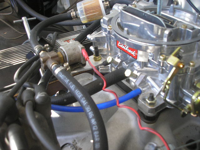

Picked up my carb, 3"resonator and my door clips this morning from the post office. My bends should be in tomorrow, but I'll be half way to Sydney by then. Took off the 2 bbl holley and multiple adaptors, fitted the new Edelbrock carb with the spacer and started connecting it up. A lot of things needed to change: the fuel inlet is now on the right side, so I had to extend/change the fuel line from the lock-off valve. The PCV comes out the front, so a new piece of hose, a new PCV valve and a modified vent cap went on. I need to fab a small mounting bracket to hold the lock-off and re-route the fuel hose a little, as it moves around too much for my liking. As the booster already has a fitting, I used the port at the rear of the carb for a 3/16" barb to feed the heater tap, jury-rigged the accellerator cable and tuned the key. Nothing. The battery from the Bronco was stone dead. OK, I grabbed the Triton battery out of the bed, jumper cabled it and tried again. Watched as the fuel filter filled with gas, gave the pedal a few pumps to get gas into the pump squirters and she fired right up. It was a little unsteady, as the carb filled all it's passages and got used to running gas through it's veins, but after a few tweeks, it idles nice and has good response. Turned it off, covered it all up and will continue next week when I get home. My parents will stay over to look after the house and the chickens, while I go look at investment properties up north. Saturday, I start on the exhaust and TV cable/accell cable install, fit a 'screen (maybe) the following week and give a run before I go back to work. It's getting closer. ;) More next week.

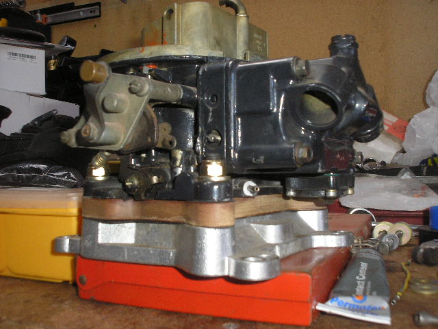

Holley and adaptor stack:

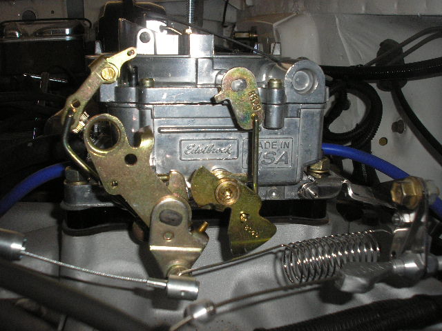

Edelrock height (installed):
Installed and running:

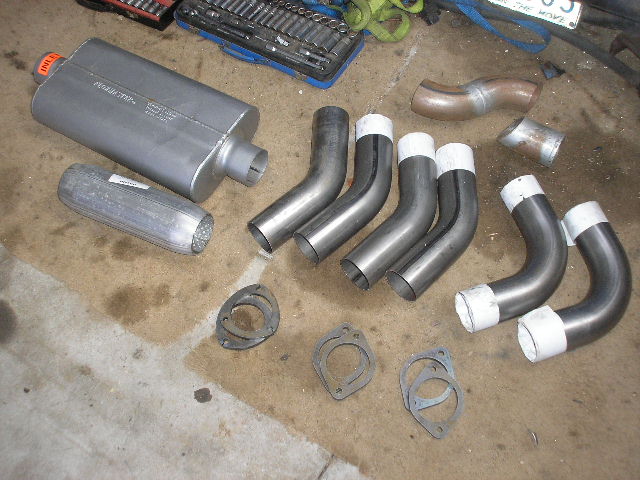

Exhaust stuff ready for tomorrow:

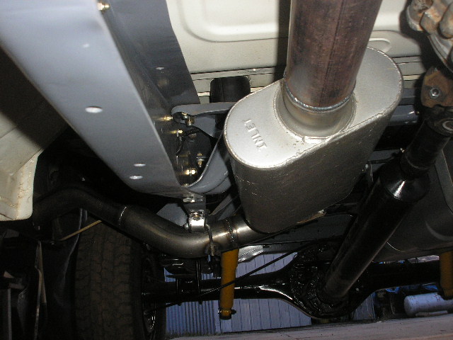

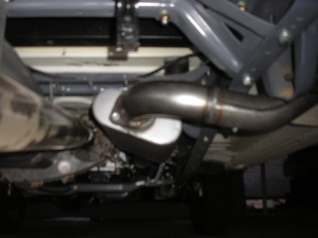

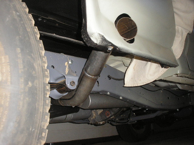

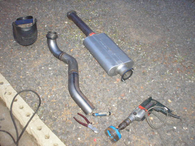

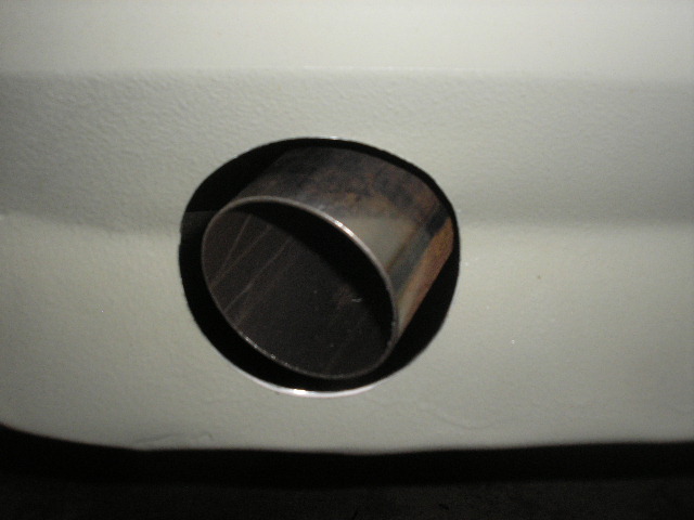

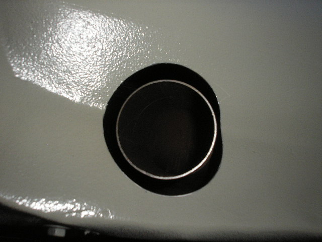

Spent a few hours on Mike's Bronco first, getting some issues out of the way, then attacked the exhaust on my truck. I had originally planned to run the exhaust out the rear, as standard, but the Flowmaster wouldn't fit between the chassis and driveshaft without rotating it vertically. That made it hang down and I didn't like it, so I brought it forward up the conector closer to the transfer case, which allowed me the run a 90 deg bend out under the frame in front of the spring hanger. After tacking the muffler and connector together and to the flange on the engine pipe, I started trimming and tacking on a series of 45 deg bends out the side. To make an exit, I hole sawed a 4" hole in the bedside and bugger me dead if the 2 bends didn't line up PERFECTLY with the hole I cut, pointing down and rearward at 20 deg angles each. After tacking them all together, I just had to start the truck up to hear what it sounded like. The sound it makes is GLORIOUS! Once it settled to an slow idle, the cam lope was perfect, we both looked at each other, big grins breaking out and we both said "YEAH!" The rasping, metallic, throaty noise this makes is pure Flowmaster! It's too bloody loud, but I've left room in front of and behind the muffler for those 12" bullets to go in to quiet it down if I have to. The new exhaust has also changed the character of the engine entirely. Without that restrictive shitheap muffler, the engine now idles easily cold, starts better and revs much cleaner. The truck EASILY lays rubber from a standing start without the brake, so I'm thinking I am going to enjoy driving this thing :D .
After cutting the hole in the bedside:
Connector, muffler and tailpipe welded up, ready to fit:
The tailpipe exit:
I need to add an inch or 2, then once I make an aluminium checker plate trim for it, I'll carefully angle cut it to match the body angle leaving it out 3/4" and paint it all heatproof black. Tomorrow, if I have time, I'll fit/weld on some hangers and secure it up, add the piece to the end, paint it and install it and then find a piece of plate to make the trim panel. Tomorrow, wiring, TV cable, tidy up a few other things and start getting ready to pack it all up for my return to work.

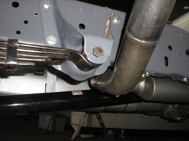

Between shopping, the weather and the idiot Handbrake, I didn't have time until this afternoon with a break in the weather to get the exhaust hanger installed. I'd bought this last R&R, so I trimmed it up, utilised an existing hole in the chassis and once the tailpipe was lined up, I welded it on. I'll pick up a couple more hangers to install, to make sure the weight of the exhaust doesn't rip it loose, then it will get painted, re-installed with sealer and I'll call it done for now. Some exhaust pics:
A bit blurry, but you get the idea:
Room for a bullet resonator if needed:
Just tilted enough to clear everything with finger space:
Hanger close-up:
Clears the spring hanger nicely:
Tucks up out of the way where it can't get hooked up:

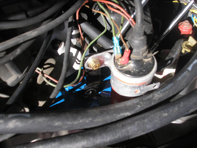

Trimmed a 7/16" UNC bolt and fitted the Mk1 coil bracket I'd made, drilled it for a 5/16" UNC bolt and mounted the coil like it was previously. I also re-did the plugs and wiring to neaten things up:

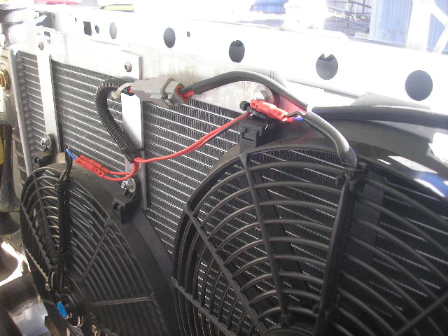

Re-positioned the fan wiring, the clips are $2 each, so zip ties will do for now:

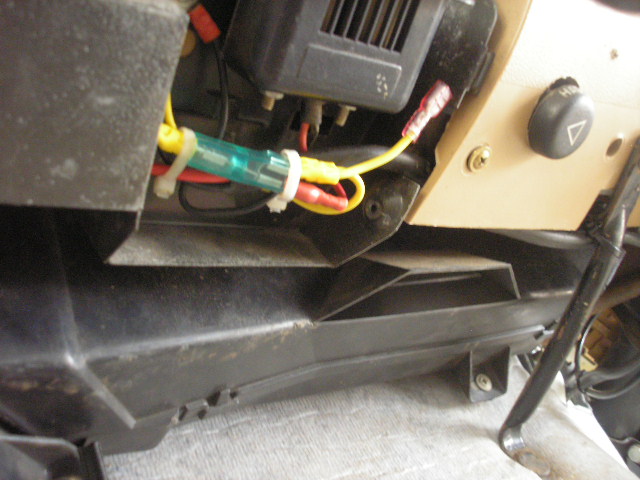

Finished off the power connector in the ashtray area and now I can listen to a CD whilst working:

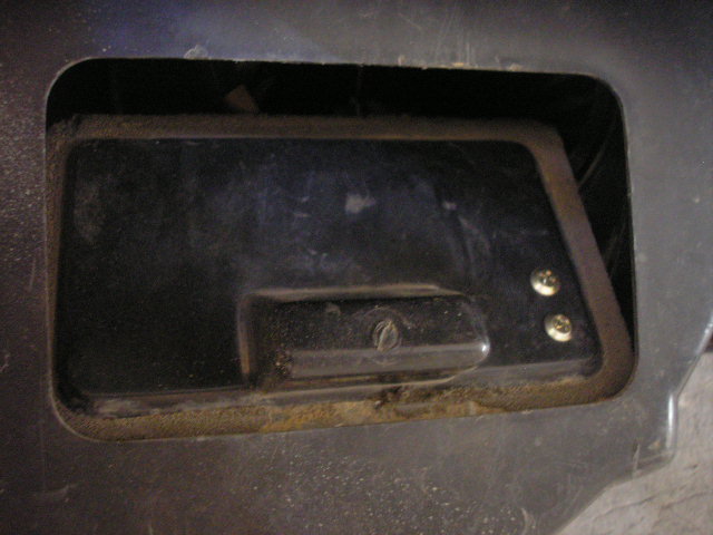

That troublesome vent flap, after the repair:

The fan wiring isn't important, as I may still go back to the factory thermo-clutch fan and shroud, if it can't handle the summer.

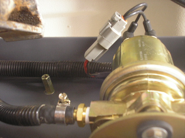

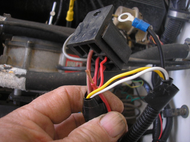

Found a male and female 2 pin Deutsch plug set, de-pinned them and installed the outers and locks onto the fuel pump connection. All good now:

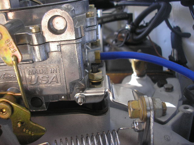

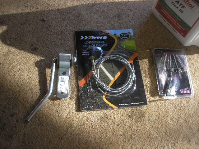

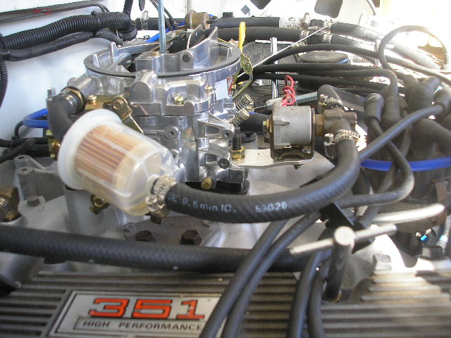

Picked up an extra exhaust hanger, and a choke cable, to use for the lift ring on the Inpco CA300 mixer. That allows me to run gasoline without the restriction of the gas mixer venturi blocking airflow:

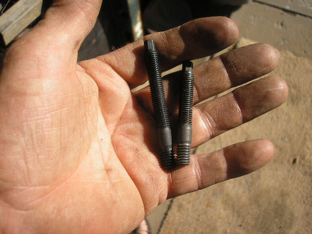

I also grabbed some longer carb studs, as the lock-off bracket and Lokar bracket didn't leave me with too many threads on the old ones. These replaced the RHF and LHR studes and gave me plenty of thread to make sure they didn't come loose and lose the nut, etc.:

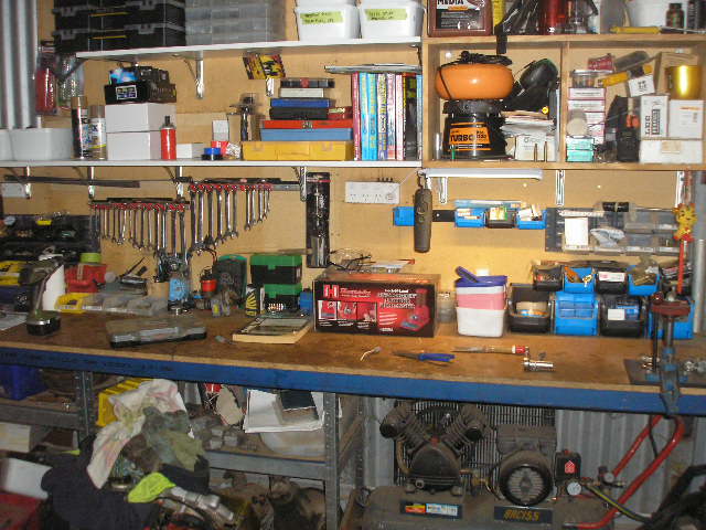

I put in a couple of shelves and did a clean-up of my bench before putting the truck away. Now, at least, I can actually work here:

I see reloading stuff...
Re: Rod's 84 BabyBajaF100
yikes wrote:I see reloading stuff...
Yep. That's also my reloading bench. The Lyman press is out of shot to the right, mounted on the same plate, next to the Simplex press. I recently invested in the Hornady auto charge kit, so I can speed up my reloading. It gets tiring measuring each charge on the scales. There is a lot of other stuff hidden away, until I set up the bungalow for my man cave and reloading centre. ;)
