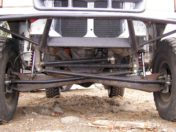

You might want to measure the amount of misalignment, Kris. If you can't go straight to the knuckle with a heim you could probably get away with a really small spacer between the two.
EDIT: With the stock steering, the driver side wheel has tons of misalignment at the outer tie-rod end, the passenger side (which is duplicated with a single swinger) has little misalignment.
Note the lack of spacers between the heims and steering knuckles.
