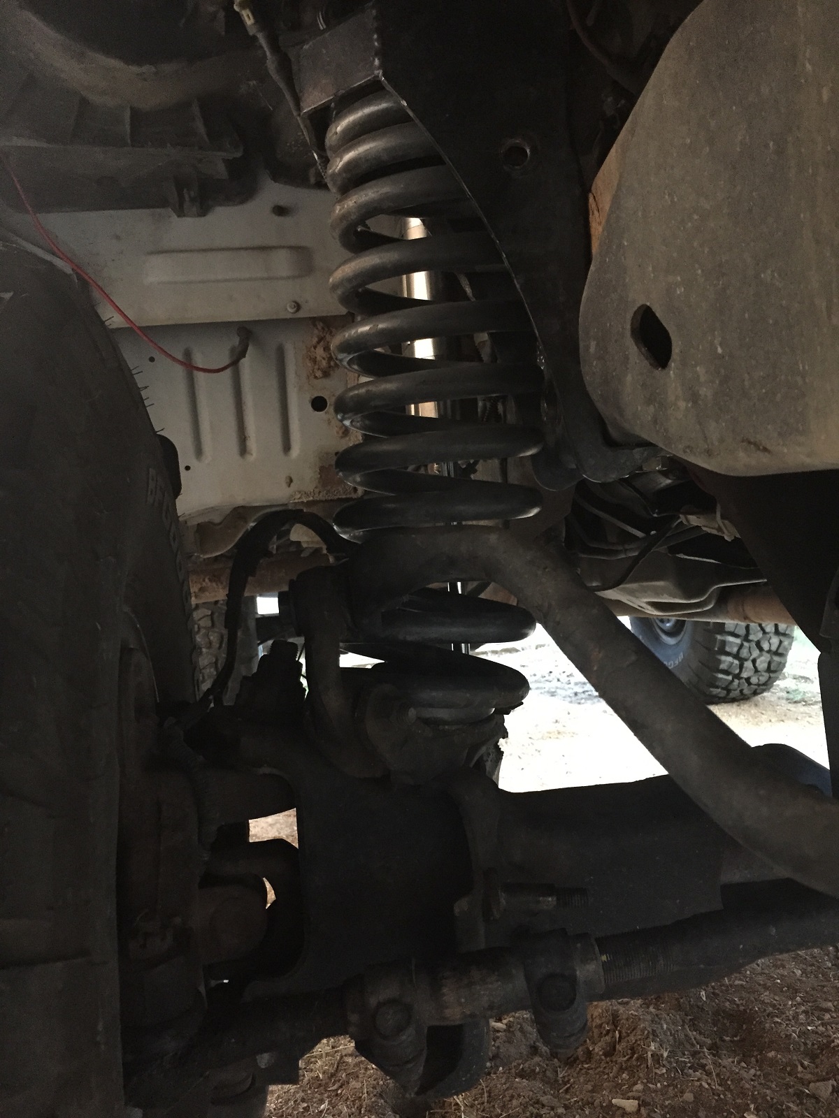

Hey Guys,
So I just swapped my front suspension over from dual shocks and a rough country coil spring over to camburg buckets, deaver coils, and bilstein 7100's.

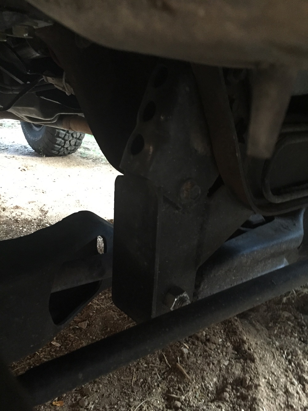

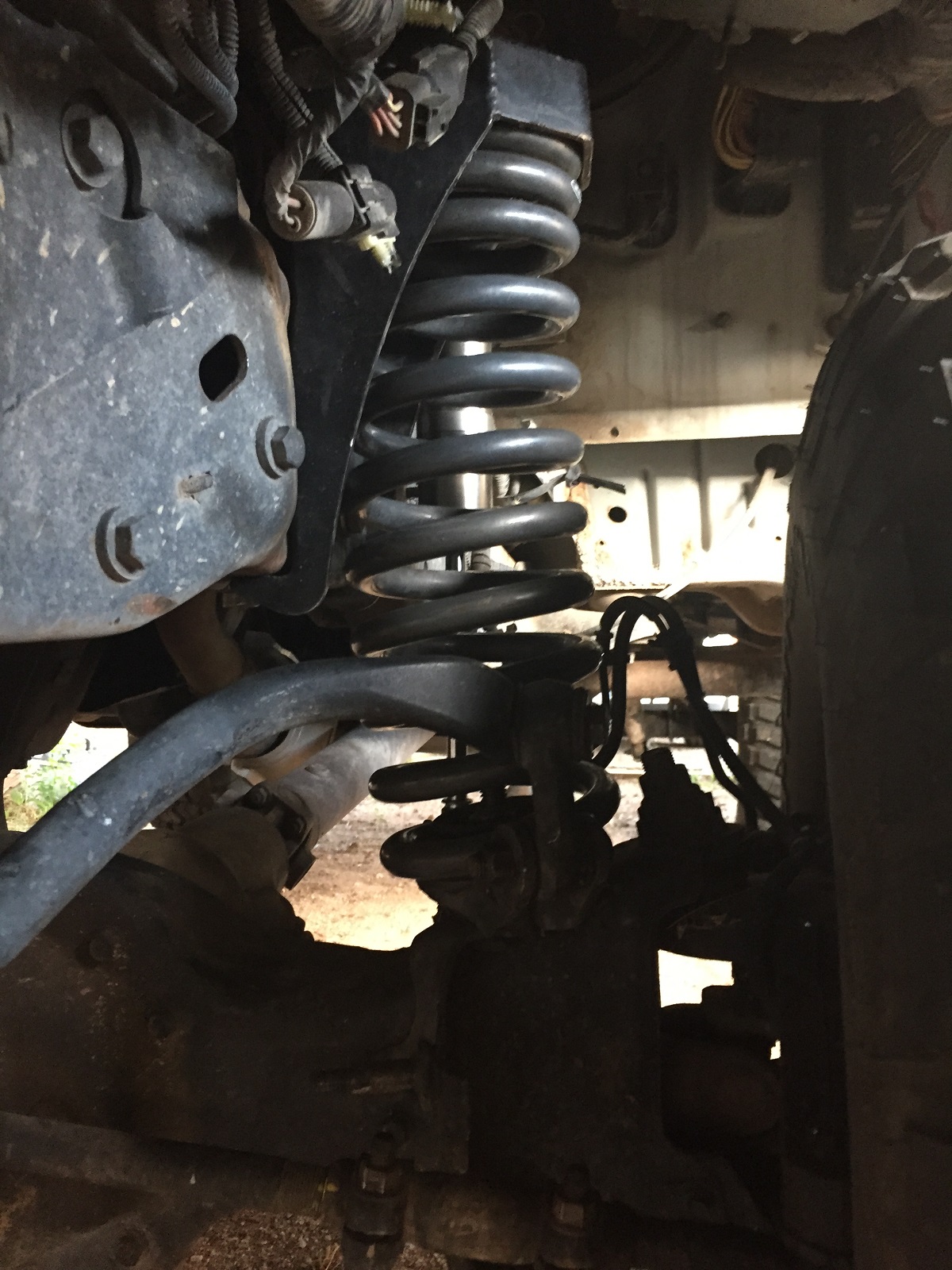

The process wasn't hard at all. However, after letting the springs settle and testing the truck, you constantly hear the spring rubbing on a bolt head. It looks like the reason its rubbing is because of how the spring is concaved in as you can see in the picture. Then, here is a close up of the spring resting/rubbing on the bolt head. The same issue persists on the other side as well, however after maneurvering the shock around I think I got it to clear the bolt head. But it is still sitting there bent inwards. How can I go about fixing this? I could possibly find some bolt heads that are not as thick and replace the ones that are rubbing.
Or, I was thinking of maybe drilling a higher hole in my drop bracket to lower the beams ends a tad. I have a 6.5"-7" drop bracket. Do you think this could be done?
Deaver Coils bend inwards?
The Camburg buckets are made for a C+T beam, not drop brackets. You need to make an angle shim for under the spring or change to C+T beams.

That's what I was assuming philofab. How would I go about an angle shim? Would my theory of drilling a higher hole on my drop bracket possibly correct it?

Coil springs have that feature. Seldom will you find a coil the does not have a bow. They get worse bow with use. Good custom tower design and ground coils allow the coil to be clocked. For the OP issue do what ever is required to clock the coil. Shaving the bolt is a temporary fix. Removing the bolt is good.

Replace the bolt that rubs with a bevel head allen bolt. Just bevel the hole so it sits flush. Most allens are grade 8 so you wont loose any strength.
