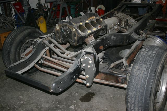

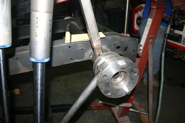

Some of you guys asked for some spy photos of Ramsey's Blazer prerunner project. Glen Straightiff is the fabricator. It's a stretch wheelbase with equal length Dana 50 based ttb up front and in the rear a 3-link 14-bolt with a trailing arm suspension. The Dana 50 uses larger axle shafts and u-joints, larger ball joints with a wider spread, a 2.5" spindle, and bigger brakes. It will still accept the D44 third member which offers more choices in gears and differentials. Notice the front beams are swapped so the passenger side pivots in front of the diff to enable the longer arms. The steering is also innovative using Toyota unit bearings for relay arm pivots, then a cv can bolt up to the unit bearing with a drive shaft to either a mid-mounted steering box or via a bellcrank to get to a front mounted steering box. Not sure what they are going to do there yet. The drivetrain is an EFI 502 and 4L80. At the back of the truck there is a pair of hubs that serve as the pivot for the trailing arms (aka Hemet arms). They are splined to accept the sway bar inside the tube. You can see they are just starting the mock up of the trailing arms and rear suspension. The rear end is a 14-bolt with the iron hubs turned down on a lathe to accept the 6x6.5 trophy truck botl pattern with a hub centric fit.
The body is a late model Blazer that has been modified to accept the old style full convertible top. Tires will be 37's.

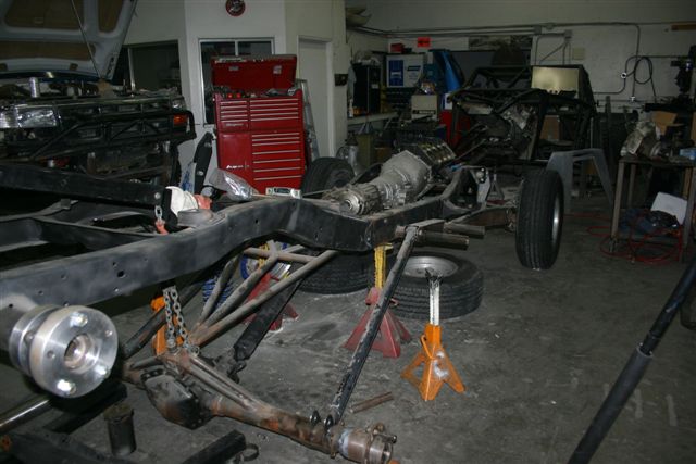

more spy shots
And yes, that's Todd Zuetcher's 69 Overall Baja 1000 winner in the background. We are finishing up the prep on it for the NORRA 1000.
