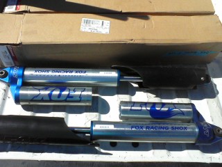

I am currently installing Raptor rear FOX internal bypass shox on the rear of my 96 Bronco to a Southwest shock mount. Also does anyone know how many bypass zones they have?

If I remember correctly I think it was three but I am not totally sure as the last time I had one open was a couple of years ago.

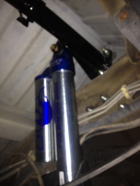

I haven't contacted Shockseals yet so I don't know about kits, which I'm not ready for anyway. I am going to Ocotillo the 24th & I still need to rebuild my front Fox 2.0 resi's that I have Shockseals sitting on the workbench. I did get 1 of the raptor 2.5's on last nite in the dark!!!

So after having to move the muffler forward about 4"s I got the other shock on this weekend. And guess what Travis, the rebound "valving is way too soft" :shock: The compression valving feels ok though. So now I 'm gonna pull them apart & re-valve the rebound.
