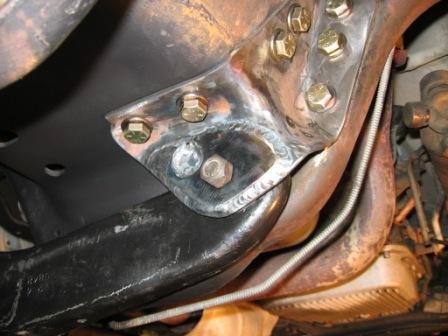

Ok not I-beam but are the factory ttb beam connection points GTG with my extended radius arms and cut and turn beams or should I plate or gusset them to add some more strength and rigidity while I have everything apart???
87 cross1.JPG (273.99 KiB) Viewed 1552 times

Hey Bob, I just bolted mine up. I've heard, if anything, drill out the ttb mount hole and weld washer it.

Bondobob wrote:Ok not I-beam but are the factory ttb beam connection points GTG with my extended radius arms and cut and turn beams or should I plate or gusset them to add some more strength and rigidity while I have everything apart???
They'll last quite a long time as they are. I'm pretty sure the same bracket pictured lasted about 15 years on Ollie's old Bronco. I think it cracked around the frame mounting bolts and not the pivot hole. I'm lazy. I would just bolt it up, but it certainly wouldn't hurt to gusset the bracket and pivot hole.
Re: I-beam Pivot Brakets
Dale (bajanorth) cracked his after a couple of years. He added weld washers and a tube from the outer part of the bracket to the bottom of the frame rail/coil bucket.
This is BajaDale's fix for cracking.
I will do the same thing on my F100.
The bolt goes through the cross member on that side which is thinker than the brackets. A weld washer on the bracket wouldn't hurt but I doubt it's needed.

I went a head and did the passenger side this way.
