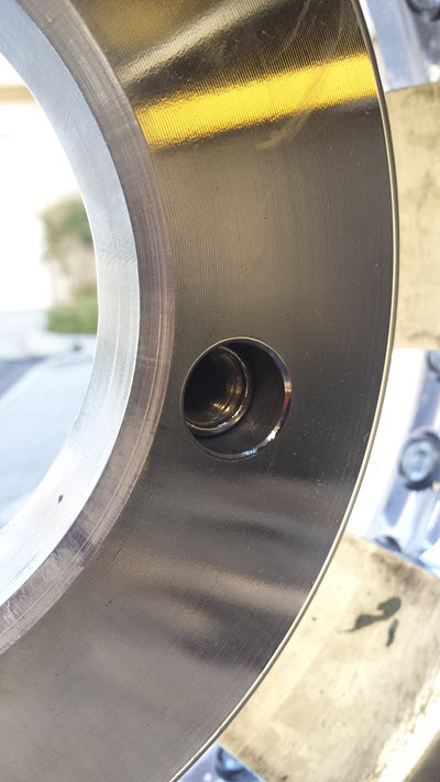

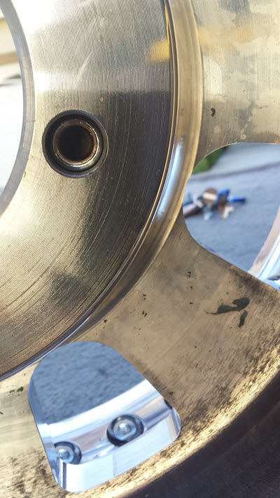

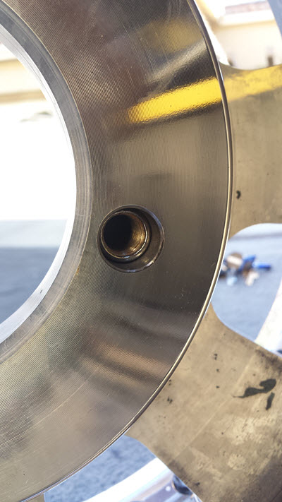

I've used the Moroso studs quite a bit. The only issue I've had is how short they are. With a hub/drum/thick wheel combo you run out of thread.

Re: 5/8s Wheel Studs
The Method's I tried to run were just over an inch thick at the bolt circle.

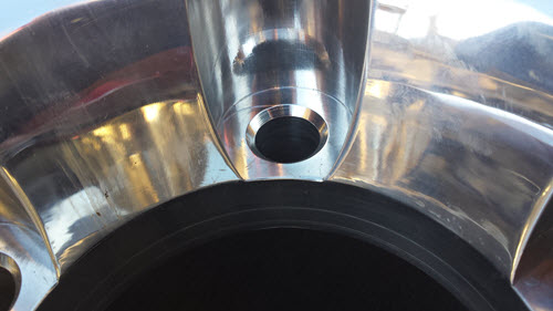

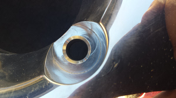

As far as the conical nuts, if you use them with the wheel holes opened up for 5/8" they will come lose as the only thing holding the wheel is the cone. If the hole is too large (for the stud) it will allow the wheel to shift resulting in lose and damaged wheels. My .02
playing devil's advocate here:
stock alcoas & many other wheels are only held on by the seat in conical nuts. They have about as much clearance between the stud & the hole for the stud as do the long neck lugs like Robert pictured above. Therefore I don't see how anything would be any different than stock.
Heck the 8 lug alcoas from the 90's HD ford trucks have holes for 9/16" studs and not all the trucks had the 9/16" studs. Some had 1/2". No major issues there that I've heard of.
Now if you're thinking just the basic conical nut like the gold colored, summit ones above with holes for 5/8" studs in the wheel, then yes, I could see a bit more of an issue there.

ChaseTruck754 wrote:playing devil's advocate here:
THIS.
I mic'ed the holes on the stock alcoas vs the holes on my Walkers that are drilled for 5/8" studs, and it's maybe 1/16" larger at most. The lug holes on the stock alcoas don't make any contact with the stock studs so they aren't doing anything but allowing the tapered lug nuts to hold the wheel in place.
PaulW
Posts: 1599
Post by PaulW »
The over sized hole in the wheel compared to the stud means the tapered contact surface is reduced. While that may seem like a small issue after beating on them for a while the aluminum will yield in that area and you will end up with greatly reduced clamping force wheel to axle. The fix and correct solution is to use washer nuts. Fly cutting is not needed for stock Alcoas and your choice of wheels may prevent cutting a flat seating surface for the nut.
So in the end with washer nuts you end up loosing the lug centric fit. Does that bother you? Not me. I have many thousands of hard miles and I cannot tell if it matters. My wheel holes are pretty tight to the studs.
Most everything we do involves a trade of of some sort.
Low cost 9/16 and larger washer nuts are available from the big rig RV suppliers.
