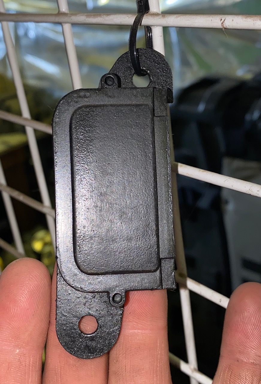

On the trucks that ridiculous 2 tank setup is the issue- you can chop the tank and weld it which is dumb imo, delete the front tank completely and run a 19 in the rear —or put a 33 gal bronco tank in or a 38 gallon tank. Personally I’d put a 33 or 38 gallon in there, and pay a body guy to cover the extra fuel door. Then if your super anal you find a F150 with a factory front delete and you put this kewl part in the dash to clean it all up!
