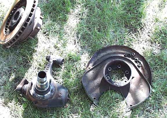

Phoenix0783 wrote:
philofab wrote:You don't have to have an aftermarket knuckle to put aftermarket calipers on. You can cut the factory mounts off of the knuckle and weld a bracket to the spindle itself. I remember seeing pics on Race-Dezert years ago but I don't remember the poster or thread.
from: http://www.race-dezert.com/forum/showth ... ot-Spacing
Just saw this picture and it looks like a pretty cool solution. Has anyone here gone to big discs and calipers lately using this method?

Re: Bronco Brake upgrade options
1Hondalover wrote:Just saw this picture and it looks like a pretty cool solution. Has anyone here gone to big discs and calipers lately using this method?
My brackets can be welded on like that. I ended up making a doubler plate that bolts over the spindle to make the bracket bolt on. I used PBR Aluminum 2003 Cobra calipers for the same reasons, so parts are easily obtainable. I haven't assembled the rear yet but I used F-body PBR calipers, the only down side is they don't have a parking brake, I built one on the transfer case output. I think there are photos on my Bronco thread.
I see the discussion and pictures that begin on page 23 of your thread Philo. It doesn't seem like you've completed the intent there.....or maybe you have yet to post the finished product? It seems like a laser cut bracket to fit on the 5 or 6 spindle studs would be the way to go. I assume one would have to fit a particular caliper and rotor.
Couple buddies have done this. Don't remember if it welded on or sandwiched between spindle and knuckle
cs_drums wrote:Couple buddies have done this. Don't remember if it welded on or sandwiched between spindle and knuckle
You can't sandwich between without causing axle length issues on 4wd. We're they 2wd?
It's a bad idea to sandwich the caliper bracket cause the snouts shear load is transferred to the knuckle via the snout shoulder. The bolts carry little shear load, the snout flange is supposed to bear it's force.

Does anyone have a finished project using this mount? Can we get a consensus here? Now that I think about it RMC is right.....pushing the spindle further out on the studs with the caliper mount "spacer" would weaken the assembly. If axle mods are necessary on the 4x4 to use the spacer version then it seems moot anyway. Did you ever wrap yours up Philo?
He must have put it on the outside of the spindle and I misunderstood. I will see if I can get some pics. I know he has a season of prerunning and 1 or 2 races on the set up.
A bolt on caliper bracket is how all the old chevy d44 stuff was. This is how guys convert to 8lug d44, swapping spindle out from chevy and cutting the ears off the ford knuckle
