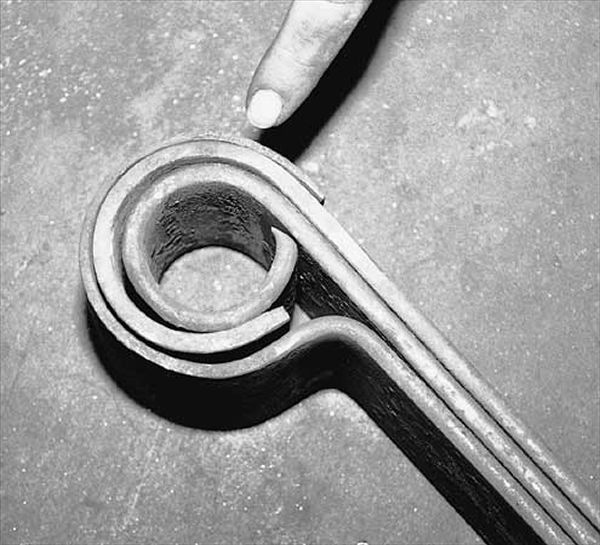

This is what a snail wrap looks like. Military wrap is something completely different.

The 64s already have a snail wrap

Yes and no. Snail wrap is the outermost wrap (similar to traction bar idea) the second is the main leaf and the inner most is the 2nd leaf, idea being the main leaf snaps the second leaf brings you home. Your picture has both.

That outer leaf is designed to only go halfway to the middle of the top of the pack as a traction adder

Yessir that's what's in the parenthesis above. I have a set of military wrapped snail shell national leaf springs. That's why I got em like that. Ill try em n see how well it works. The nationals have the security of the first n second leaf incase the main leaf breaks ( military) and the anti wrap leaf ( snail shell). You can get non snail shall and snail shell non military wrapped. My nationals have both.

Typo above. Dang no edit! Snail wrap not snail shell sorry.
