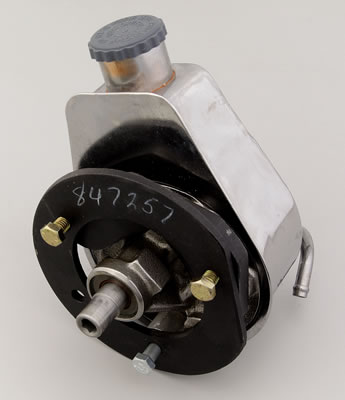

What I DID find is a performance replacement C2 pump built by AGR Performance for the Bronco...part #809156. About $136 from SummitRacing.com [http://www.summitracing.com/parts/agr-809156/] See photo below... ...and here is their sales description for the #809156:

But then I did further searching tonight and found that AGR also builds what they call the "Super Pump"...a Saginaw-style pump that they list for (my) '96 Bronco as Part No. #867257. Yet I can only find a picture of their #847257 Super Pump which shows a Cardone-type steel adapter that looks like it allows their Super Pump to bolt to the aluminum P/S bracket on my '96. But the #847257 which they list for the 80-89 Bronco.
Even though the A-1 Cardone 60-7272 is apparently no longer available...anywhere...there apparently are a few options still yet available. All of this can be found here at AGR's website: http://www.agrperformance.com/Off-Road- ... rmance.htm[/color]

I also confirmed that both the #867257 "Super Pump" Saginaw P/S pump for the '90-'96 Broncos...and the #847257 "Super Pump" for the '80-'89 Broncos BOTHhave the cast iron horse collar bracket attached to the front of the Saginaw pump (see picture above...with the 847257 part number written in chalk on the casting.) This bracket allows these pumps to bolt up directly to the stock Ford C2 P/S bracket...albeit with some "slight trimming" of the aluminum casting (top and bottom) to permit the 'canned ham' reservoir of the Saginaw pump to fit properly! Matt informed me that the shaft is also turned down to accept the original pulley from the C2 pump!

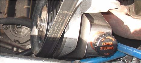

He referred me to this .pdf that shows what some of the trimming looks like in order to fit the canned ham housing into the bracket (http://www.agrperformance.com/AGR-Insta ... nstall.pdf). A few of those pictures also appear below...
Matt also mentioned that there is another option available to these two Super Pumps that further enhance their longevity. He said if you add the letter "T" to the end of the part number (when ordering), you get a stronger pump shaft, thrust bearings, special seals, and some other changes that really turn the pump into a special heavy duty model. Please call them for details.

- This is what the final trimmed bracket and pump assembly looks like...on an F-250 Super/Duty...
- 2013-06-24 17.32.24.jpg (30.55 KiB) Viewed 2849 times
- 2013-06-24 17.32.59.jpg (53.04 KiB) Viewed 2849 times
- 2013-06-24 17.33.11.jpg (37.21 KiB) Viewed 2849 times
- 2013-06-24 17.32.47.jpg (43.12 KiB) Viewed 2849 times
