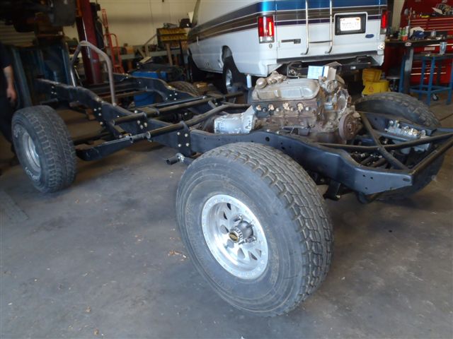

The race project is a roller now. Here's a few pictures. Drive axles, brakes, steering, suspenison all done. Time to start on the body and cage.

Am I seeing that right Chris? Are you by chance changing the rake of the frame to achieve more bump travel?

How far back is that motor compared to stock? What travel numbers are you getting with that link setup?
Build the truck around the suspension... that's the right way to do it for sure.

The engine is in the stock location using Autofab motor mounts, but we replaced the bushings with machined aluminum pucks. We have 20" front travel and 24" rear travel. Although the leafs are not in it yet and it may not droop out all the way with leafs installed. It did with our mock up leaf but once the full pack is installed and has some miles on it it may loose some arch. The frame rake you see is just a function of where we set the ride height. Right now it's just sitting on metal spacers. The rear spacer is too tall.
