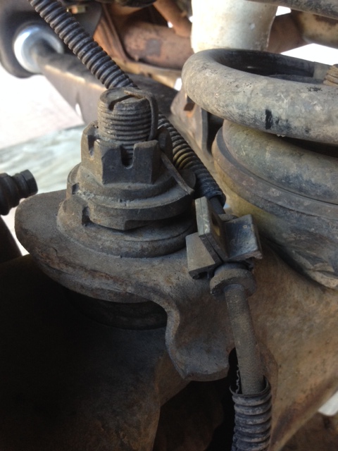

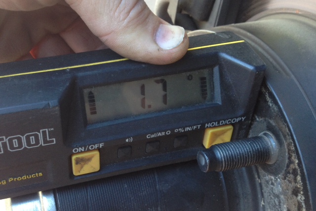

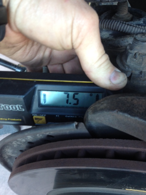

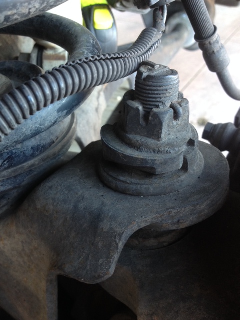

Like the title said-- I am about to do the C&T and would like to see if you all would chime in on my measurement methods. On the pics with the jackstands I put them in what I believe is the exact same spot on the beam/knuckle intersection at the jackstands lowest position. From there I measured the camber at the hub on both sides and the caster at the flat portion at the forward portion of the knuckle. The pics of the upper BJ nut is to show the adjuster and find out if those are the stock straight up units. If you all think the measurements are good then I will continue on with putting in the lift coils and then take the measurements again.
Thanks for the help,
Matt

Here are the adjusters pics-- if these are adjusters or just stock non-adjustable pieces.

Re: Pre - C&T Measurement Methods-Double Check My Work
Post by Willwater »
it looks to me like it has non zero degree camber bushings in it. Just pull the castle nut and the degrees should be stamped on the top of the bushing. It would be preferable to start with zero's but if you just cut enough to return it to your current readings you should be fine. Do you plan to put everything back together to remeasure after you cut the lower balljoint mount out? I personally would just measure the angle between the two balljoints using a straight piece of rod passed through both ball joint holes. That way you don't have to put it all back together to check it after tacking.
I personally just pie cut mine and bent them until the pivot point was 4" higher than it started. I was being lazy and didn't feel like tearing things apart and putting them back together that many times. It is only a degree off right now with brand new springs in. So close enough to align with standard bushings once things settle if they do. You are doing it the more precise way though. But don't put too much thought into it.
I am assuming you pulled you radius arms off so it doesn't screw with the angle when you put the lift springs in? I don't know if it will pull camber off or not, but it is certainly going to screw with the caster badly if you leave them on for measurements.
