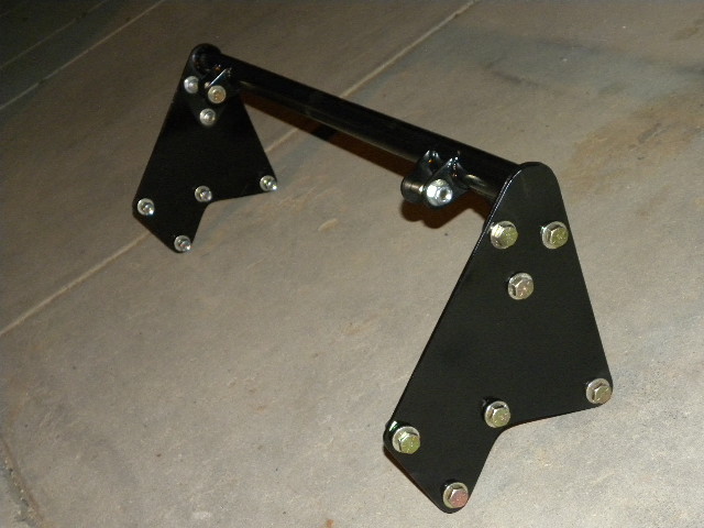

Does anybody know where to find this type of rear shock mount?
Phoenix0783
Posts: 658
Location: Bend, OR
Re: Rear shock mounts
Post by Phoenix0783 »
Autofab and Solo Motorsports for sure. Probably Camburg too.
Posts: 6026
Threat sells one too. I haven't looked at each side by side to tell you what brand that one is though.

That's the threat mount. I have the same one

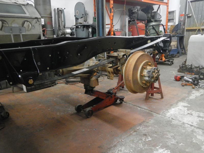

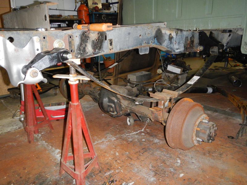

Here's a few pics of my setup. It drops out 16.5" bumped and strapped with a 10" shock under the bed:

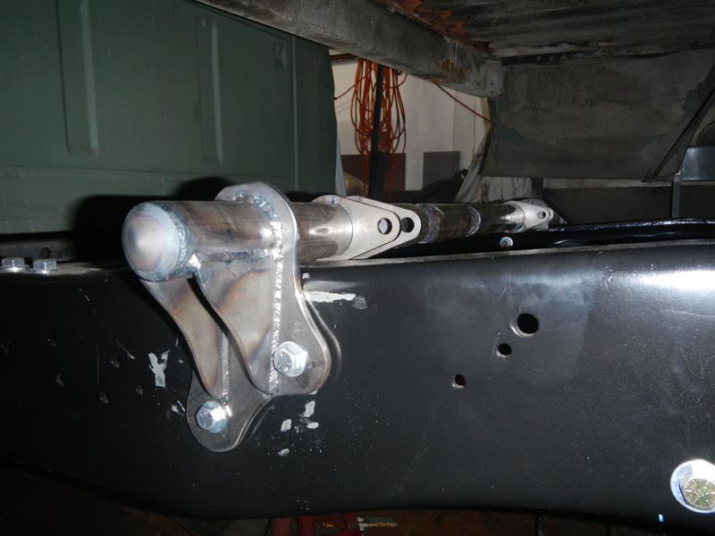

here's mine. I can't remember what my travel is for sure, but as I said I have 8" shocks & limited bump about 3-4" before metal to metal and droop about 6-8" before metal to metal just to make things work. I have 64" springs designed for a Chevy 2500 on my crew though.
x 430.jpg (69.91 KiB) Viewed 3944 times
Bump is about like this
x 213.jpg (95.35 KiB) Viewed 3944 times
& droop about like this
8-1-12 rear droop.jpg (112.29 KiB) Viewed 3944 times

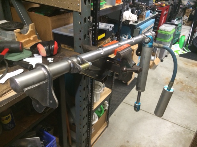

Honestly the fab on these isnt hard. I have about $50 in materials into mine, i couldnt justify the $450 price tag. Think i have about 3-4 hours into it with cycling. Getting a little over 16" with 12" shocks. Its not a pickup but not realy a bronco either.
