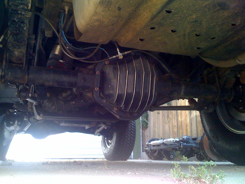

When I bought my Bronco with 141,000 miles on it, the original owner had already rebuilt the factory 8.8-inch axle twice. And he never had more than 32-inch tall tires on the truck! I was considering putting a 9-inch under it, but for the cost of what I'd want, I couldn't justify the price. So i decided to bolt in a 10.5-inch 14-bolt rear axle in my Bronco.
These axles have 1.5-inch axle shafts, full-floating wheel hubs, three pinion bearings (like a Ford 9-inch), 3 3/8-inch diameter, 1/2-inch wall axle tubes, and a 10 1/2-inch ring gear. I equipped mine with 12 1/2-inch disc brakes, 4.88 gears, a 1410-series pinion yoke, and an ARB Air Locker. As an added bonus, replacement parts for this axle are available at any Autozone.
- 14-Bolt Bronco.jpg (152.02 KiB) Viewed 1692 times
