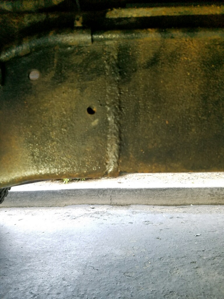

I have looked at a few - they cut 2 frame & weld them together using the bronco back section like I mentioned above. Here's the pics of one C-150 I looked at.

That’s the worst way to put 2 frames together.
Re: Centurion F-150
yup. but it's what Centurion & Magnum did...

Anybody else notice that the frame ends aren't lined up real well? Looks like they are almost 1/8" off on the one side.
Also why the C150's were shorter than the 250/350's.

If you've ever had much of a look at one of these things & how they put them together you would NOT be impressed. Well, if you're anything like me that is... There are still a lot of them on the road though after 30 years or so, so I guess they can't be THAT bad (rust roof issues aside).
