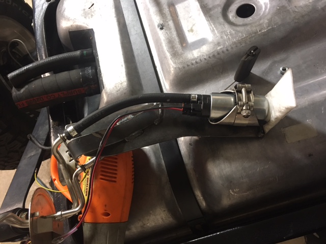

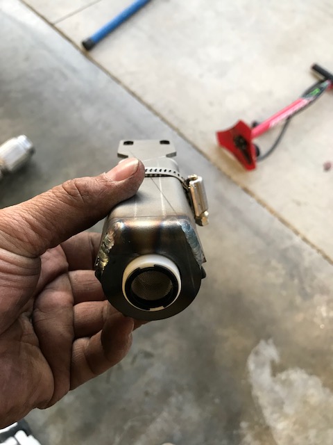

Hello All,
I made a bracket to hold the new Walbro 255lph fuel pump in place and I made it out of mild steel- should I have this like nickel plates so it won't rust, leave it bare mild steel, I'm pretty sure powdercoat won't last or the nuclear option and remake in SS?? Gas tanks rust out all the time but that's after many years.
Thx,
Matt

Re: Custom Fuel Pump Hanger- Plate or Not
With it being submerged much of the time I think you MAY be fine IF you fill your tank often & don't let the truck sit with half a tank very much.
My concern would be all the surface rust/crap that will accumulate on the plate when the truck has half a tank & half the bracket is exposed to the air. Then that crap gets washed off when you fill & it floats around until it gets stuck in the pump or filter.
If if were me I'd make it out of 316 stainless.
Stop over-thinking it. Put it back in and go play.
No finish is needed, make sure it clean when installed
It you're going to remake, use aluminum. Then it wont need to be coated.
