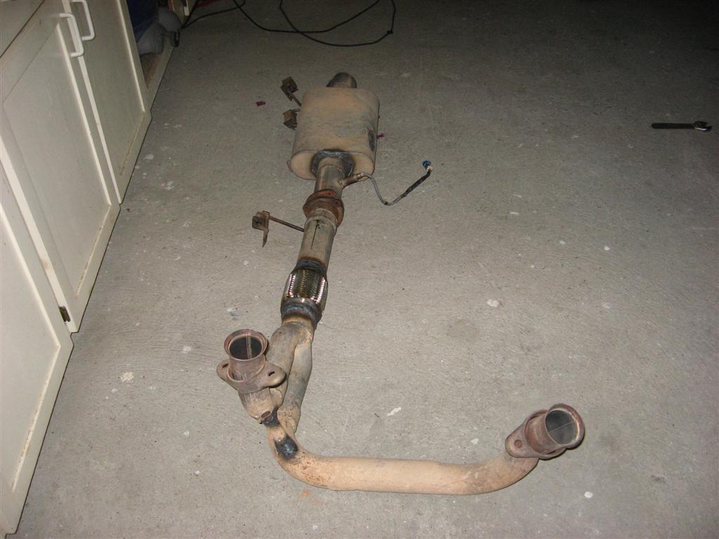

Something I recommend and another I do not recommend.
After much breakage of the hangers and finally the muffler was cracked at the inlet all around the pipe.
I got a SS bellows from Summit. Should solve the breakage.
The muffler eqwas the shortest one we could locate at the time. Dont like it It is a Flowmaster Lenght is 13" or 16" pipe to pipe. It was suggested that a magnaflow would be quieter.
3" from the Y to the outlet.
