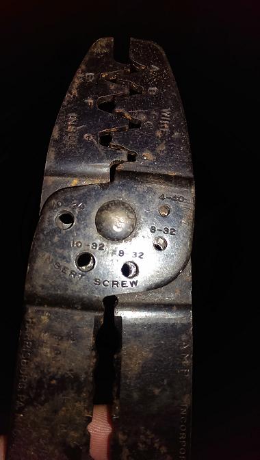

These are the ones I used. They dont look so bad in person, the flash made it look horrible.

Yup those are molex crimpers, those guys are cheap at orvac with no brand name on em, I have an identical pair for crimping pins for haas machine connectors aka molex. There's better ones out there but those work great. Just be sure to line up the sleeve ears ( the parts of the pin that get bent into a 180 back onto the insulation).

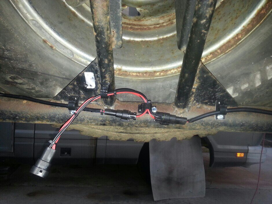

I only paid around $20 on my Weather Pak crimper. I use them on the Race Radio power connectors and replace old Molex plugs. I also use them on my lights.
I will be doing a complete new rewire on my Bronco and I found a label maker that prints on heat shrink. has any used them and do they last. I like the idea of labels with clear heat shrink.

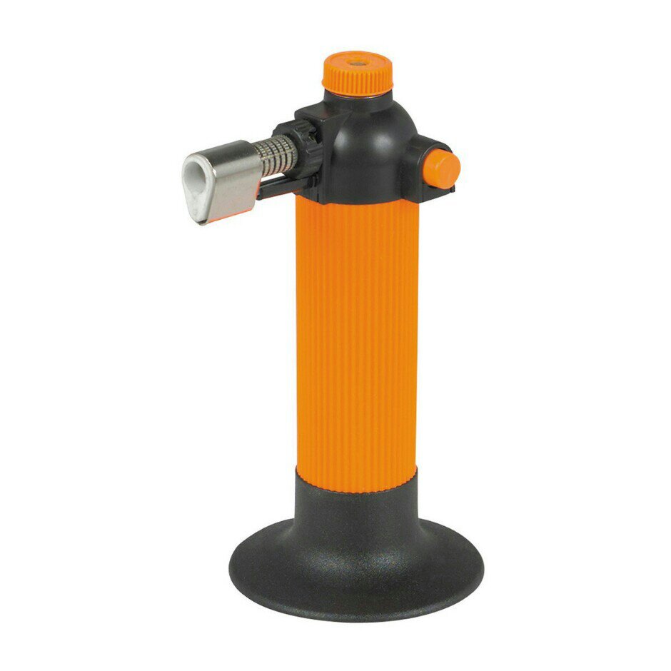

I do a lot of wiring for intercoms and Race Radios. For several years I have been using a Harbor Freight Micro Torch. For under $9 it was worth trying. Runs on butane and after several years it has been a rare tool from HF that has lasted. I know I should just get a heat gun. I have one old loud one that is like a old hair dryer, just easy to use the torch.
