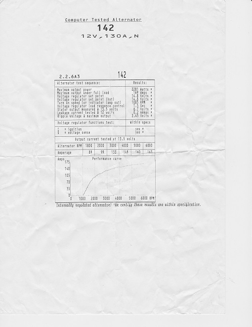

Let me help
Fireguy/Ryan sells a 200A unit the has diy diodes in a G3 frame The should fit any full size Bronco/F150.
Of course you can always overdrive with just a change in pulley. Same guy sells those.
http://www.rjminjectiontech.com/collections/alternators
Are we on the same page? What is your need for huge output?
Here is more info
Review the pics & note the pic title. One is generic info from his site and the other is the dyno test for the one I bought. Mine is advertised as a 130a and it came out 169amps. Typical from others.
Sure beats the 95a my rig came with. Anybody want a perfectly excellent stock 95a one? New reg and bearings.
pw
- Alt GenericR.jpg (94.04 KiB) Viewed 981 times
- My G3 test (2).jpg (70.93 KiB) Viewed 981 times
