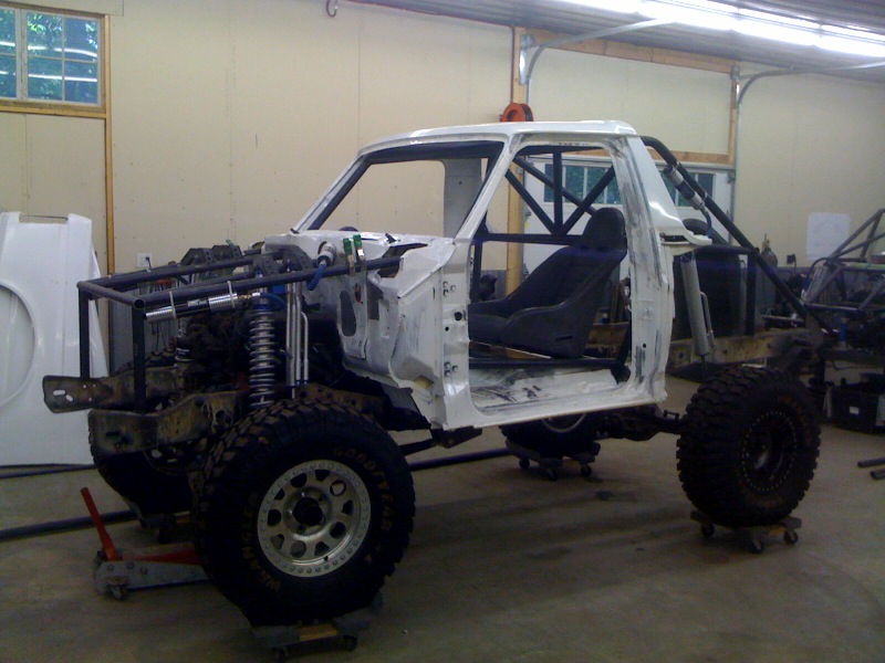

Re: Rear suspension
How do you get rid of all the crap you don't need if you don't cut up your truck!?mkiefer wrote:Yes cutting up your truck is lame......
- side w seats.jpg (125.61 KiB) Viewed 1307 times

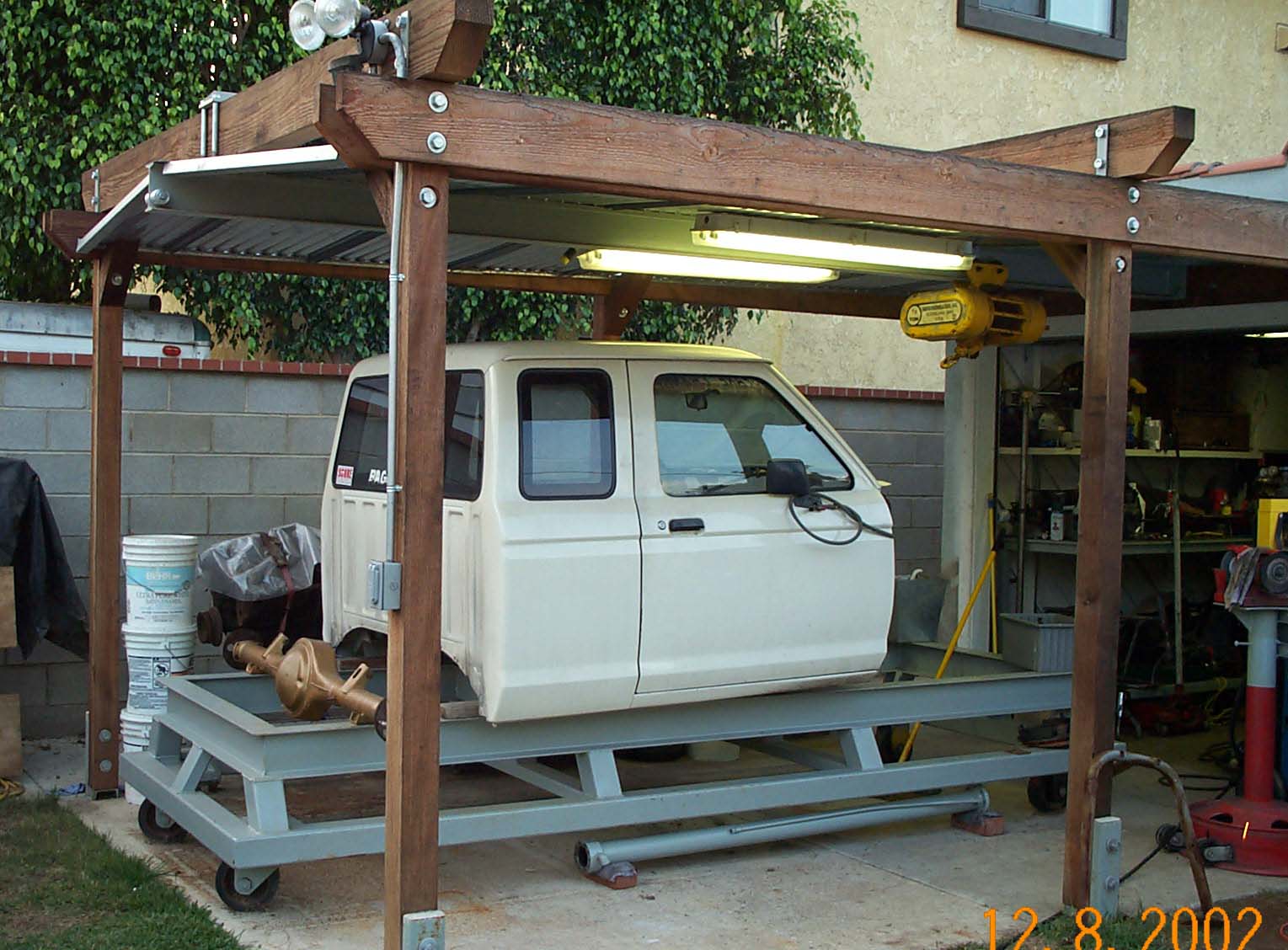

Re: Rear suspension
eh...
Floor wasn't even cut out yet here
