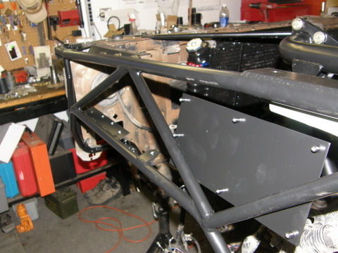

HTO,
Just a couple of pics on how I solved the problem. I have Autofab glass up front (fenders and hood) and I built a frame core support instead of skinning my fenders. So, I welded brackets to the core support frames to help hold things in place. I've also fab'd up aluminum fender wells and they are stout enough that I mounted the vacuum canister, the air pump intake filter and muffler and my +12v power distro strip directly to the fender wells.
On the driver's side, I mounted the air box, the fuse box and the ICM to the core support frame.
Just my approach...
pass inner wheel well
drivers side core support (3).jpg (123.2 KiB) Viewed 1737 times
core support, air box
drivers side core support (11).jpg (139.67 KiB) Viewed 1737 times
driver's core support
drivers side core support (9).jpg (147.04 KiB) Viewed 1737 times
drivers core support
drivers side core support (6).jpg (139.35 KiB) Viewed 1737 times
Re: Underhood Placement
On the passengers side
pass side
pass side
front end build 004.jpg (122.6 KiB) Viewed 1737 times
pass side
pass side
front end build 003.jpg (123.47 KiB) Viewed 1737 times
