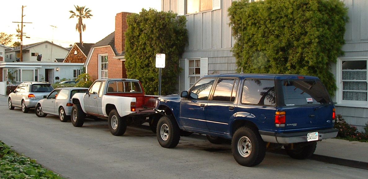

Nice score. I emailed him a month or so back and held back on looking as he said "2wd" to my 1st question, and I wasn't sure I wanted to find what you found. Let me rephrase that... I was nervous for the sake of my marriage I would find what you found! No pics in the ad when I saw it, and the Dad couldn't email or text them so that helped my case for holding back as well. I totally would have converted that to 4wd for the price he was asking. It's even the color of my old one (pic for nostalgia sake). Again, glad I didn't go look as I'm currently still married LOL.
Looking forward to see how you clean this one up & what you do with it.
