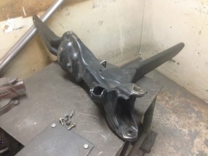

the beam my buddy Dave did for me also Dana 44HD and Dana 50 snouts side by side.

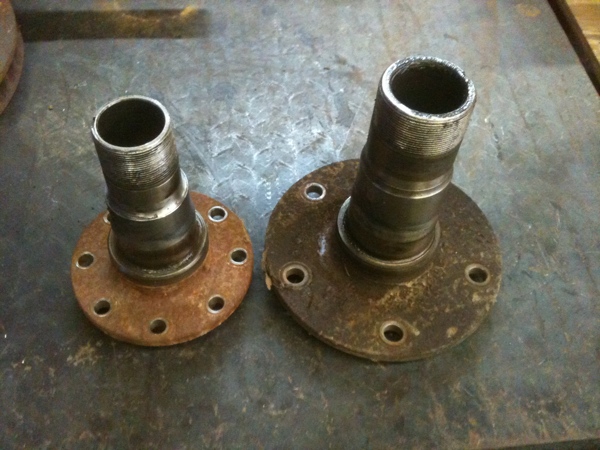

Took these today d50 vs d44
